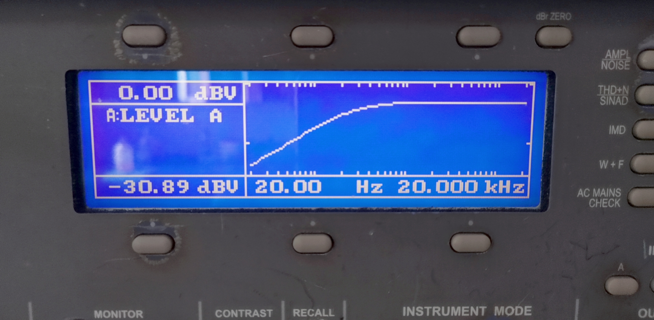

使用TLV320AIC3254 ,配置和接法如下,但测试频晌出来,低频没了,是配置问题?
GPIO_WriteBit(GPIOC , KT_RES ,RESET);
Delay_ms(100);
GPIO_WriteBit(GPIOC , KT_RES ,SET);
Delay_ms(100);
IIC_Write(0x30,0x00,0x00);
IIC_Write(0x30,0x01,0x01);
Delay_ms(100);
IIC_Write(0x30,0x04,0x43);
IIC_Write(0x30,0x05,0x91);
IIC_Write(0x30,0x06,0x07);
IIC_Write(0x30,0x07,0x06);
IIC_Write(0x30,0x08,0x90);
IIC_Write(0x30,0x0B,0x82);
IIC_Write(0x30,0x0C,0x87);
IIC_Write(0x30,0x0D,0x00);
IIC_Write(0x30,0x0E,0x80);
IIC_Write(0x30,0x12,0x87);
IIC_Write(0x30,0x13,0x82);
IIC_Write(0x30,0x14,0x00);
IIC_Write(0x30,0x15,0x80);
IIC_Write(0x30,0x19,0x03);
IIC_Write(0x30,0x1B,0x00);
IIC_Write(0x30,0x1E,0x81);
IIC_Write(0x30,0x3F,0xD6);
IIC_Write(0x30,0x40,0x00);
IIC_Write(0x30,0x41,0x00);
IIC_Write(0x30,0x42,0x00);
IIC_Write(0x30,0x44,0x0F);
IIC_Write(0x30,0x45,0x38);
IIC_Write(0x30,0x51,0xC0);
IIC_Write(0x30,0x52,0x00);
IIC_Write(0x30,0x53,0x00);
IIC_Write(0x30,0x54,0x00);
IIC_Write(0x30,0x00,0x01);
IIC_Write(0x30,0x01,0x08);
IIC_Write(0x30,0x02,0x01);
IIC_Write(0x30,0x09,0x30);
IIC_Write(0x30,0x0C,0x0C);
IIC_Write(0x30,0x0D,0x0C);
IIC_Write(0x30,0x0E,0x08);
IIC_Write(0x30,0x0F,0x08);
IIC_Write(0x30,0x10,0x00);
IIC_Write(0x30,0x11,0x00);
IIC_Write(0x30,0x12,0x40);
IIC_Write(0x30,0x13,0x40);
IIC_Write(0x30,0x33,0x60);
IIC_Write(0x30,0x34,0x80);
IIC_Write(0x30,0x36,0x80);
IIC_Write(0x30,0x37,0x80);
IIC_Write(0x30,0x39,0x80);
IIC_Write(0x30,0x3B,0x00);
IIC_Write(0x30,0x3C,0x00);
