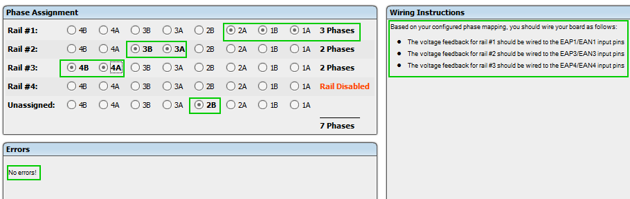

    The Fusion Digital Power Designer (FDPD) controls how the phases are split between the FPP sections and should not allow an invalid configuration, see below examples.
    First I attempted to create an invalid configuration with 2 three phase rails and a dual phase rail, but I tried to split the A and B phases of FPP2. As you can see the GUI has flagged the error and will not let me proceed.  It is not possible to create 2 three phase rails and a single dual phase rail even though there are eight phases on the UCD9248.
    Below I have changed the rail/phase configuration to a valid phase breakdown of a single three phase rail and two dual phase rails, only then will the GUI allow me to move forward.  Here Phase 2B has been Unassigned because the 2A phase was used for Rail#1.  Notice that the GUI provides information on how to connect the rails to the FPP error amps on the right hand side of the window, this will depend on the rail/phase breakdown as well.
    This is one example, the UCD9248 can be configured in a number of rail/phase combinations:
    4 - single/dual phase rails (single/dual relates to A/B phases of each FPP, a single phase rail assigned to an A phase will result in the B phase for that FPP to be unassigned)
    2 - three/four phase rails
    1 - three/four phase rail and 2 - single/dual phase rails
    1 - five/six phase rail and 1 - single/dual phase rail
    1 - seven/eight phase rail
