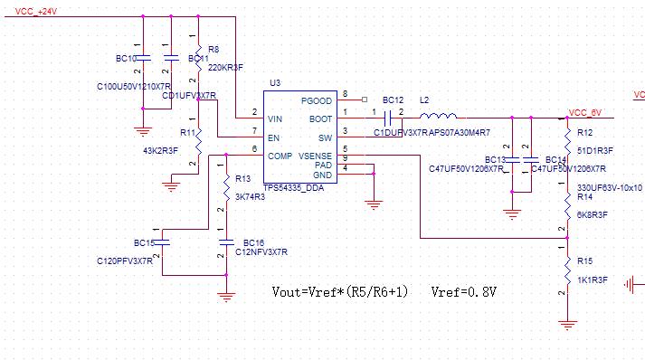

Using tps54334 switching power supply chip, the chip burn rate in the field is more than 30%
Other Parts Discussed in Thread: TPS54334
Using tps54334 to reduce 24V to 6V, the load current is relatively small, about 24Ma.
After four months of operation, the chips were burned down, with a rate of 30%.
The burning phenomenon is: all the SW pins are short circuited to the ground, even some boot pins or VIN pins are short circuited to the ground, and some PGOOD pins are short circuited to the ground.
The accessories are schematic diagram, PCB diagram and SW oscilloscope signal.
