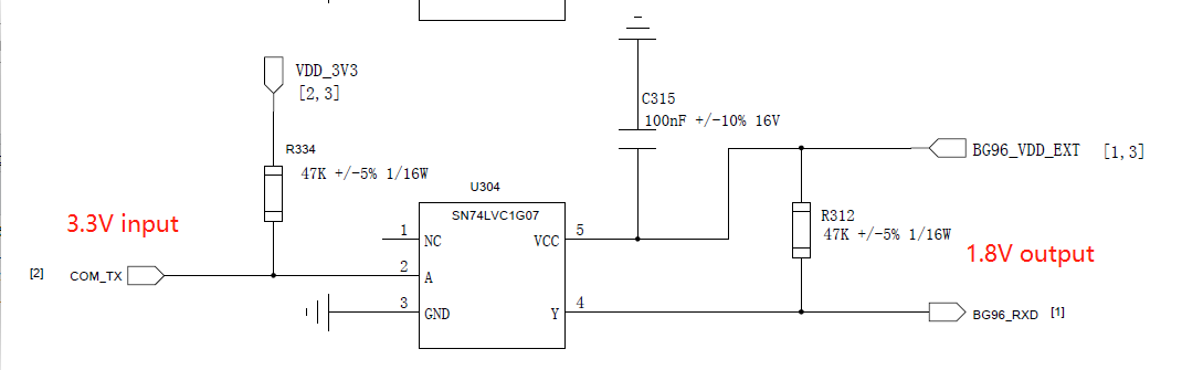

We are using SN74LVC1G07 for 3.3V UART to 1.8V UART. The VCC=1.8V, A port = 3.3V input, Y port = 1.8V output. The design of SN74LVC1G07 is shown in below.
Does this design will casuing latch-up?
