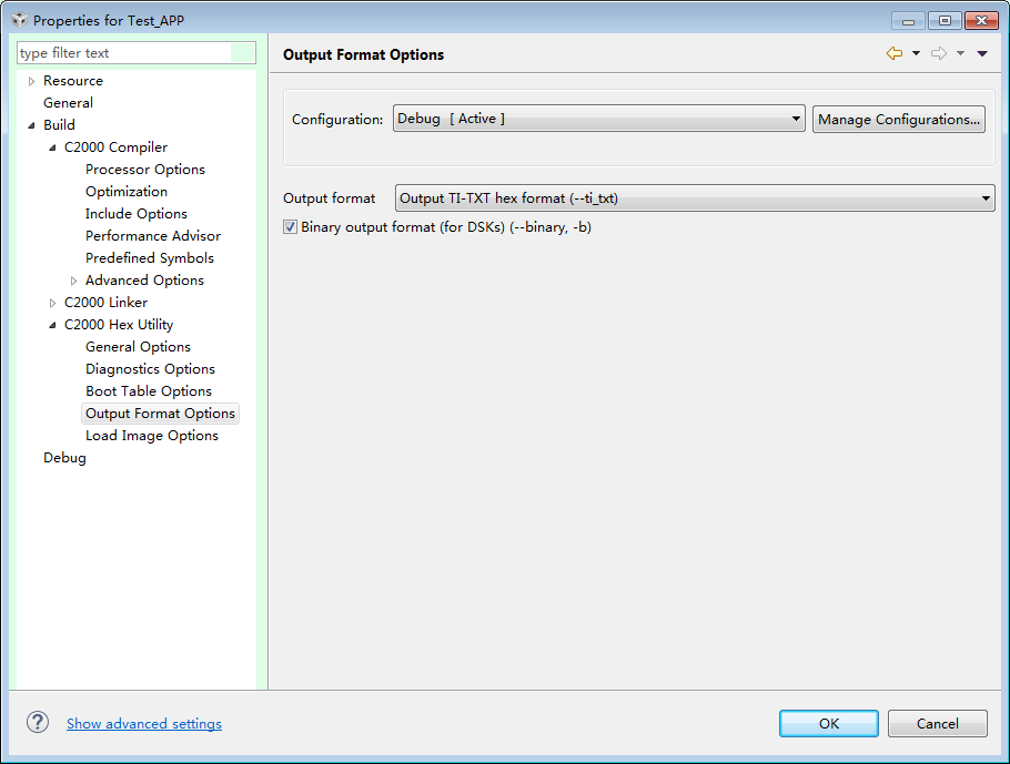

CCS Version: 7.3.0.00019 如何生成bin文件?

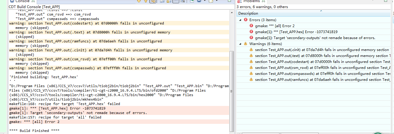

这里加入这些命令后依然无法生成bin文件,应该怎么设置呢?我用的是28069M

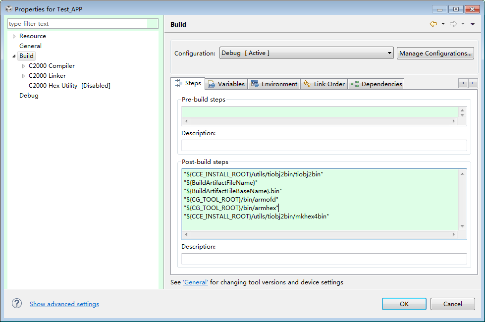

添加的内容为:
"${CCE_INSTALL_ROOT}/utils/tiobj2bin/tiobj2bin" "${BuildArtifactFileName}" "${BuildArtifactFileBaseName}.bin" "${CG_TOOL_ROOT}/bin/armofd" "${CG_TOOL_ROOT}/bin/armhex" "${CCE_INSTALL_ROOT}/utils/tiobj2bin/mkhex4bin"
