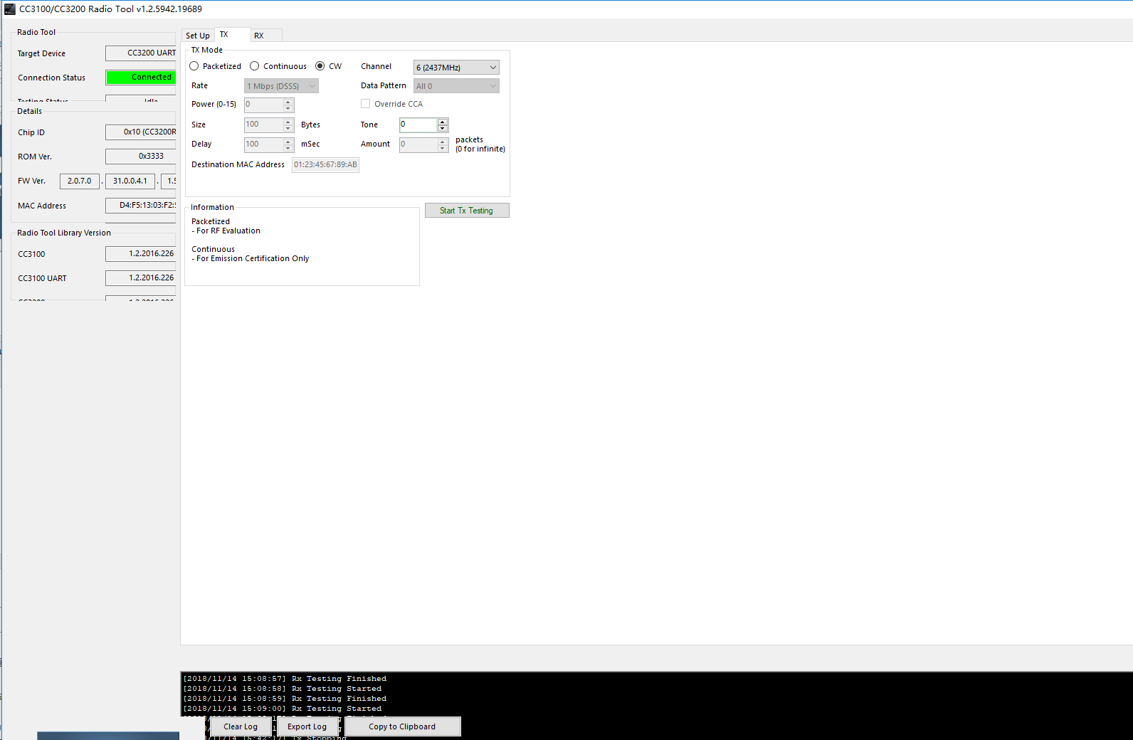

CC3200定频是什么意思是指定信道吗?
做测试让定频,不知道怎么设置成定频。
看到下面的channel了没?你在做FCC测试的时候需要根据当地的规定的频段做测试。
Q:
How much of the firmware can be changed before re-approval of the HW is needed. ? Since we are dealing with programmable PHY devices these days …
A: Any increases in power levels, frequency channels, etc would require recertification.
我们要做FCC测试,要求要设置成定频模式,您看这样设置对吗?
