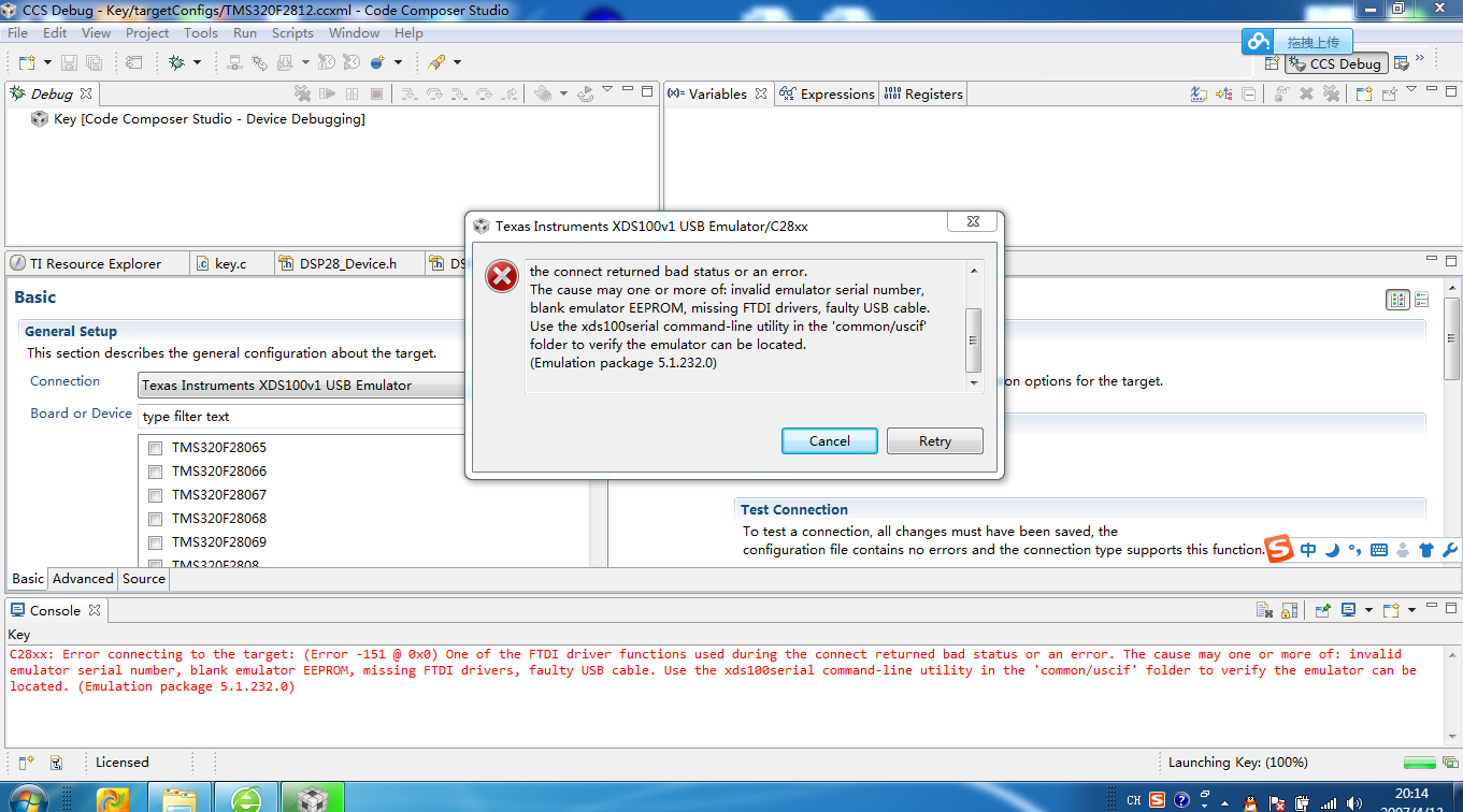

CCS5.5 用XDS100V1 调试程序 出现错误
不知是硬件问题还是软件设置问题 求支持
  • 你好。
    从你的截图来看,好像你的仿真器上的FTDI芯片没有写入XDS100V1的程序。
    请参考http://processors.wiki.ti.com/index.php/XDS100。下载MPROG3.5和ept文件对FTDI进行烧录试试。
    Q: How do I reprogram the VID/PID EEPROM if it has not been programmed correctly?
    • A If your VID/PID EEPROM has been programmed incorrectly, or not programmed at all, you can reprogram it with these simple steps
    1. Download and Install MPROG from FDTI.  You can get MPROG 3.5 from here
    2. Download and extract the ept file from here
    3. Connect your XDS100 to the PC via the USB Cable
    4. Execute MProg.exe from within the directory structure where you installed MPROG.  You should see a screen like the one pictured below.
    5. Select File->Open, and select the XDS100_wUART.ept file you extracted
    6. Select Device->Scan to verify that it will talk to your XDS100
    7. Select Device->Erase to erase the existing programming
    8. Select Device->Program to program the correct settings
    9. Close MPROG
