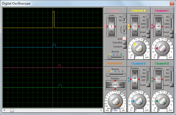

28027无法生成带死区互补的PWM的问题,急求!
 我的代码如下,开发平台是CCS4,仿真平台是PROTEUS。如果去掉死区代码,可以正常生成波形。搞了很多天了,请大神技术支持帮忙解答。另外一个问题,未设置EPWM2与EPWM3,但两者都有输出,相对于EPWM进行了移相。怎么回事?如何解决?

	EPwm1Regs.TBPRD = 20000; //设置PERIOD,由于是增减模式,所以PERIOD=2*TBPRD Tpwm=period*sysclock
	EPwm1Regs.CMPA.half.CMPA=8000;
//	EPwm1Regs.CMPB = 300;
//	EPwm1Regs.CMPB = 500; //计数2000时,改变高低电平,用于设置占空比
	EPwm1Regs.TBPHS.half.TBPHS = 0; //相位设置为零
	EPwm1Regs.TBCTR = 0; //从零开始计数
	EPwm1Regs.TBCTL.bit.CTRMODE = TB_COUNT_UP; //增减模式,生成对称波形
	EPwm1Regs.TBCTL.bit.PHSEN = TB_DISABLE; //关闭相位
	EPwm1Regs.TBCTL.bit.PRDLD = TB_SHADOW;//频率加载采用影子式加载
	EPwm1Regs.TBCTL.bit.SYNCOSEL = TB_CTR_ZERO;//关闭同步
	EPwm1Regs.TBCTL.bit.HSPCLKDIV = TB_DIV1; //分频设置
	EPwm1Regs.TBCTL.bit.CLKDIV = TB_DIV1;//分频设置
	EPwm1Regs.CMPCTL.bit.SHDWAMODE = CC_SHADOW;//比较器影子式加载,另一种为立即加载
	EPwm1Regs.CMPCTL.bit.SHDWBMODE = CC_SHADOW;
	EPwm1Regs.CMPCTL.bit.LOADAMODE = CC_CTR_ZERO; //
	EPwm1Regs.CMPCTL.bit.LOADBMODE = CC_CTR_ZERO; //
	EPwm1Regs.AQCTLA.bit.CAU = AQ_SET;//增计数至比较器时至低电平
	EPwm1Regs.AQCTLA.bit.CAD = AQ_CLEAR;//减计数至比较器时至高电平
//	EPwm1Regs.AQCTLB.bit.CBU = AQ_CLEAR;
//	EPwm1Regs.AQCTLB.bit.CBD = AQ_SET;
	EPwm1Regs.DBCTL.bit.IN_MODE=DBB_ALL;
	EPwm1Regs.DBCTL.bit.POLSEL=DB_ACTV_HIC;
	EPwm1Regs.DBCTL.bit.OUT_MODE=DB_FULL_ENABLE;
	EPwm1Regs.DBRED=20;
	EPwm1Regs.DBFED=20;
