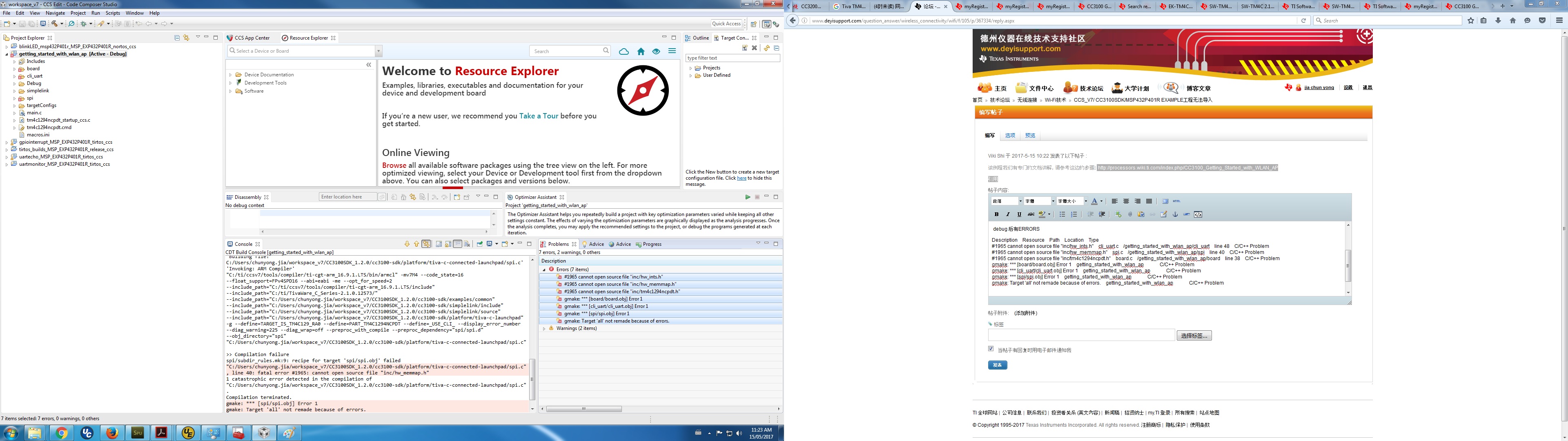

你好,
我用上面的配置搭建环境,当我想导入下面的工程时
C:\ti\CC3100SDK_1.2.0\cc3100-sdk\examples\getting_started_with_wlan_ap
无法导入,会产生两个错误。
Error 1:
Description    Resource    Path    Location    Type
File connections/Stellaris_ICDI_Connection.xml does not exist.  Was included by file C:/Users/chunyong.jia/workspace_v7/getting_started_with_wlan_ap/targetConfigs/Tiva TM4C123GH6PM.ccxml    Tiva TM4C123GH6PM.ccxml    /getting_started_with_wlan_ap/targetConfigs    line 0    Problem
Error 2:
This project was created for a device not currently supported: Cortex M.TM4C123GH6PM. See 'Help > Check for Updates' or visit <a href="liveaction:OpenAppCenter">CCS App Center</a> to get the latest device support. Alternatively, migrate the project to closest matching supported device by adjusting project properties.    getting_started_with_wlan_ap        project    Problems
请问该如何解决。谢谢

    无法找到文件 : sl_common.h
     debug 后有ERRORS
    #1965 cannot open source file "inc/hw_ints.h"    cli_uart.c    /getting_started_with_wlan_ap/cli_uart    line 48    C/C++ Problem
    #1965 cannot open source file "inc/hw_memmap.h"    spi.c    /getting_started_with_wlan_ap/spi    line 40    C/C++ Problem
    #1965 cannot open source file "inc/tm4c1294ncpdt.h"    board.c    /getting_started_with_wlan_ap/board    line 38    C/C++ Problem
    gmake: *** [board/board.obj] Error 1    getting_started_with_wlan_ap             C/C++ Problem
    gmake: *** [cli_uart/cli_uart.obj] Error 1    getting_started_with_wlan_ap             C/C++ Problem
    gmake: *** [spi/spi.obj] Error 1    getting_started_with_wlan_ap             C/C++ Problem
    gmake: Target 'all' not remade because of errors.    getting_started_with_wlan_ap             C/C++ Problem
