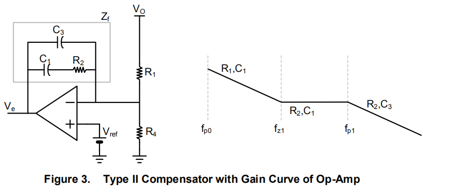

It is known that the Type II/III feedback network is connected to the inverting pin of error amplifier. the output voltage sample is connnected to the inverting pin. the reference voltage is connected to the noninverting pin.

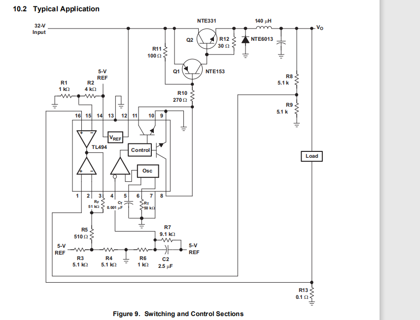

And in the TL494 buck converter, there is only a regisiter in the feedback network and the feedback network is connected to the inverting pin of error amplifier. but the output voltage sample is connected to the noninverting pin, the reference voltage is connected to the inverting pin.
Is the Type II/III compensation needed/suitable for TL494?
If the answer is yes, How to do?
If the answer is no, How to keep the TL494 buck converter stable?
