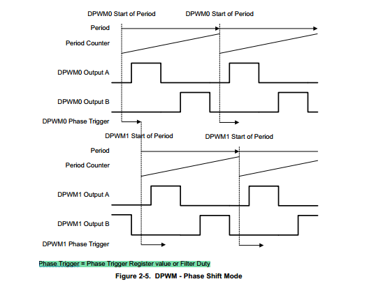

为何pwm2A和pwm3B没有移相交错,而是完全重叠的?
Dpwm2Regs.DPWMCTRL0.bit.MSYNC_SLAVE_EN = 0;
Dpwm3Regs.DPWMCTRL0.bit.MSYNC_SLAVE_EN = 1;
Dpwm2Regs.DPWMPHASETRIG.all = PWM_SLAVESYNC;

Dear Neil,
I have a question,could you please help give some suggestion?Thanks!
For voltage mode control of PSFB topology,how can I realize the the mechanism of phase shift:Phase Trigger =Filter Duty?
In other word, Which register can help realize these function as the picture shown below?
