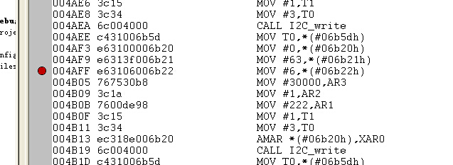

5509I2C问题
我用5509的I2C读写时钟芯片ISL12026。
程序如下:
#define   WriteAddress        0xDE
#define   ReadAddress        0xDF
以上是设备读写地址
/* This next struct shows how to use the I2C API */
/* Create and initialize an I2C initialization structure */
I2C_Setup I2Cinit = {
        0,              /* 7 bit address mode */
        0,         /* own address - don't care if master */
        12,            /* clkout value (Mhz)  */
        50,            /* a number between 10 and 400*/
        0,              /* number of bits/byte to be received or transmitted (8)*/
        0,              /* DLB mode on*/
        1               /* FREE mode of operation on*/
/*I2C is undet reset*/
        I2C_RSET(I2CMDR,0);
        /*设置预分频寄存器,I2C的mode clock is 10MHz*/
        delay(100);
        I2C_RSET(I2CSAR,0x001A);
        I2C_RSET(I2CMDR,0x0620);
        I2C_FSET(I2CSTR,BB,0x1); /* Writing a 1 to BB Bus busy bit is supposed to clear it*/
    I2C_setup(&I2Cinit);
        //myI2C_setup(&I2Cinit);
          /*设置I2C的Mater clock*/
        I2C_RSET(I2CCLKL,100);
        I2C_RSET(I2CCLKH,100);
    I2C_getConfig(&testI2C);
以上是初始化。

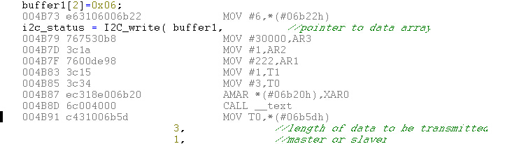

buffer1[0]=0x00;     //高位地址
        buffer1[1]=0x3f;          //地位地址
        buffer1[2]=0x02;           //数据
    i2c_status = I2C_write( buffer1,          //pointer to data array
                                    3,                                //length of data to be transmitted
                                    1,                                //master or slaver
                                    WriteAddress,            //slave address to transmit to
                                    1,                                //transfer mode of operation
                                    30000                        //time out for bus busy
以上是写数据。用观察窗口看  i2c_status的值是3.
