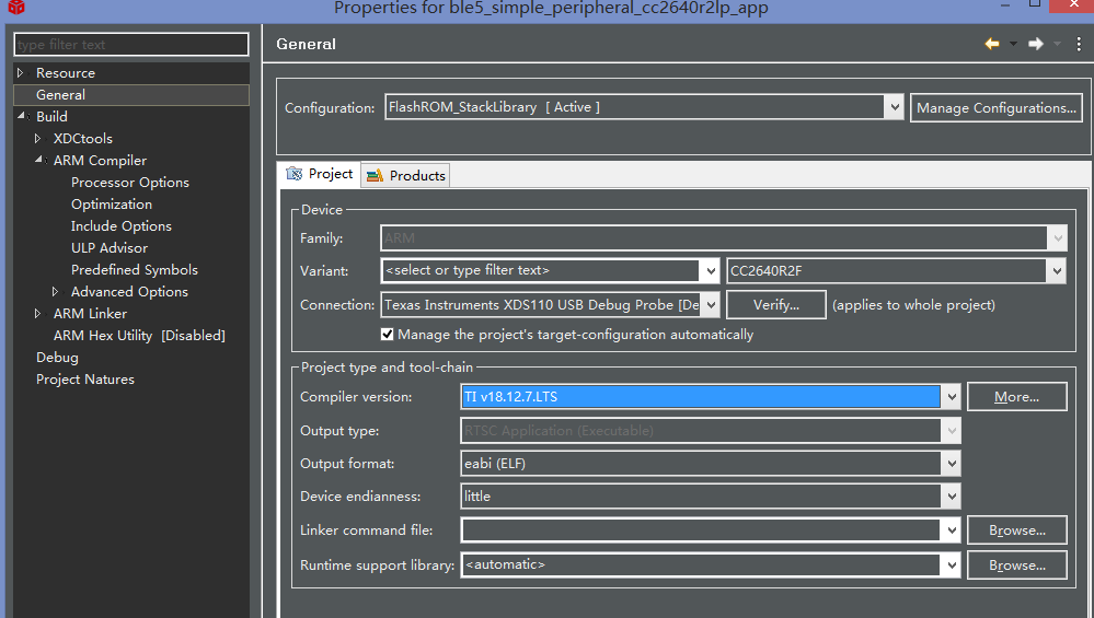

使用CCS9或者下载18.12.2.LTS版本编译器
Dependencies
SimpleLink CC2640R2 SDK 4_30_00_08 was built & tested on a Windows host platform using the following Integrated Development Environments (IDEs) and components. Using an IDE or toolchain version not listed below may result in compatibility issues with this SDK release.
IAR Embedded Workbench: EWARM-8.32.2
TI Code Composer Studio: CCS-9.0.0.00013
TI Code Generation Tools for Arm: 18.12.2.LTS
XDCTools: 3.51.03.28
