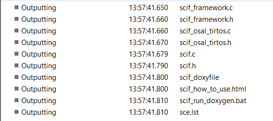

如何将SCS生成的SCIF文件添加到CCS工程中?
  • Which Files Do I Need to Add to My Application/Project?
    (Optional) Move the SCS project file (.scp) into your project folder and set the Source code output directory to your source project folder. Then the SCS compiled source files (driver and framework) will be updated directly in your application workspace.
    SCS will generate the following files that you need to include (mandatory) in your project:
    - scif.c ( AUX RAM Image, IO Mapping, SC RAM variables memory address, some low level functions)
    - scif.h
    - scif_framework.c ( General Driver Framework )
    - scif_framework.h
    - scif_osal_tirtos.c ( OS Specific )
    - scif_osal_tirtos.h
    我们有个添加SCS代码到project0的指导文档,请参考:www.ti.com/.../swru537.pdf
