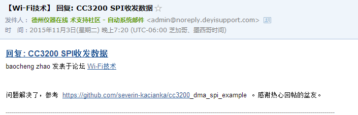

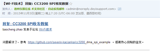

具体参考的 https://github.com/severin-kacianka/cc3200_dma_spi_example
