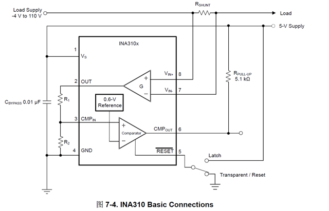

May I know a question about the application of INA310A2 for the customer?
If “In+” is disconnected and “In-” is connected, the “OUT” is low.
If “In+” is connected and “In-” is disconnected, the “OUT” is high.
If “In+” and “In-” are both disconnected, the “OUT” is low.
The results above are simulated in Tina. Could you tell me if my conclusion is correct?

  • 您好,
        INA310A 在输入端具有一个电荷泵,,使输入端能够低于接地电位。
        当IN+ 和 IN- 悬空(floating)状态,芯片无法提供正确的输入偏置电流(IB)来使芯片按预期工作。
        参考相关案例,输入悬空时,输入端表现的电压为负,具体您可以测试一下。
         当放大器的输入处于悬空(floating)状态时,建议您使用下游电路屏蔽输出,即在您有已知输入之前,忽略放大器的输出。
