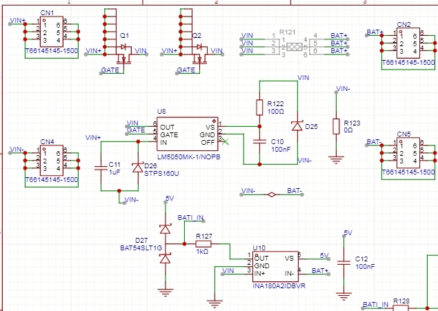

INA180: INA180A2IDBVR用作电池充电器电流检测,高侧LM5050放倒灌,未开启充电时,接入电池后偶发INA180直接烧毁
Part Number: INA180
INA180A2IDBVR用作电池充电器电流检测,高侧LM5050放倒灌,未开启充电时,接入电池后偶发INA180直接烧毁Schematic1
