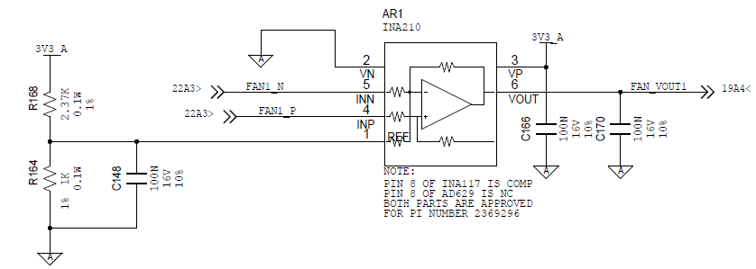

Hi,
I use INA210, pls refer to attached file.
the current is 0~0.5A.
INA210 gain is 200. hunt resister is 0.02ohm.
so 0.02*0.5=10mV
10mv*200=2V
Vref is 1V
the max Vout is 1+2=3V.
if there is no current, the Vout should be Vref =1V, but it is 3.3V.
I tested the current from 0 ~0.5A, the Vout always fixed at 3.3V.
I don't know the reason.
pls help me to  slove this issue.
