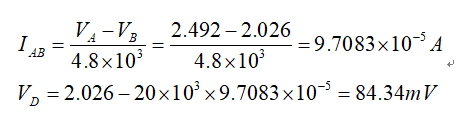

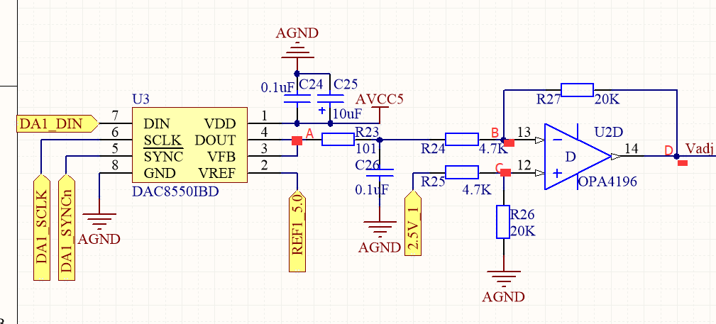

运放供电电压为:+11.91V;-12.02V。2.5V_1=2.502V
DAC输出(A点)电压为:2.492V; 运放OPA4196反相端(B点)电压为2.026V;运放OPA4196同相端(C点)电压为2.025V;运放OPA4196输出端(D点)电压为90.4mV?;
