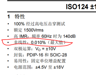

芯片手册的非线性:0.010%如何理解以及检测,求指点
  • 您好,非线性指的是输出电压与最佳拟合直线的峰值偏差,表示为偏差与FSR之比。
    在datasheet中也有描述:Nonlinearity is the peak deviation of the output voltage from the best-fit straight line, and is expressed as the ratio of deviation to FSR.
