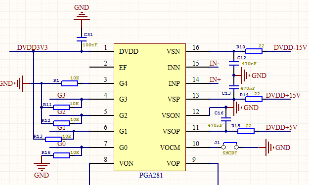

设计中PGA281作为第一级放大衰减电路,单端输入,差分输出,控制增益为1时,VOCM引脚悬空,输入交流正弦信号,输出信号峰峰值等于输入信号峰峰值,但有一个非常大的直流分量。输入直流电压时输出电压确有衰减,非常不解,把VOCM引脚接地,输出没有直流分量了,但峰峰值衰减为输入的0.5,此时设置的倍数仍为1呀,望指导,在线等,PGA281部分原理图见附件
The output signal is fully differential around the common-mode voltage (VOCM). The VOCM input pin is typically
connected to the midsupply voltage in order to offer the widest signal amplitude range. VOCM is a highimpedance input that requires an external connection to a voltage within the supply boundaries. If the VOCM pin is left floating, the output common-mode voltage is undefined, and the amplifier will not operate properly. The usable voltage range for the VOCM input is specified in the Electrical Characteristics and must be observed.
