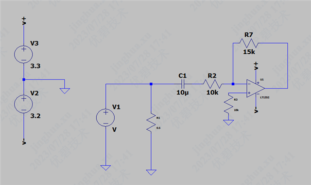

I was using TLV9152 for a 1Meg bandwidth current sensing application. Below is the part of circuit I found problematic.

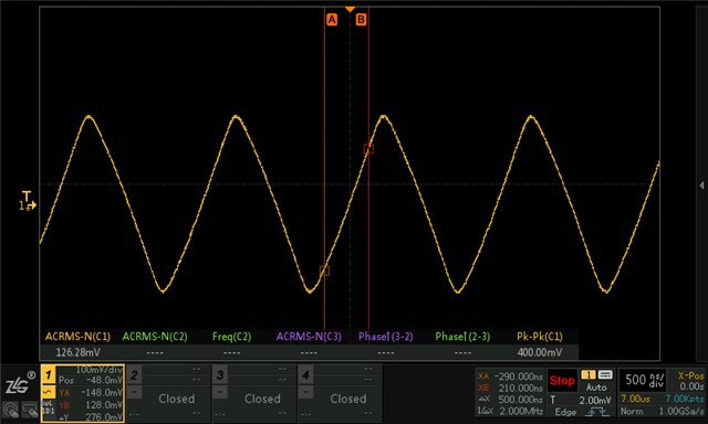

I tested the circuit with a signal generator,inputing 600KHz 270mVpp sine wave, the output is a sawtooth wave, showing a slew rate of 552mV/uS. Which is far below the specified 21V/us.

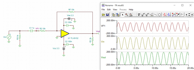

The output gets sinasoidal when reducing the input voltage or frequency .
Where may go wrong with this?
