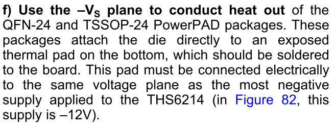

打算用THS6214做一个设计,对Datasheet中的某些描述有些疑惑,特提出向各位高人请教。
第3页对PowerPad有如此描述:
(1) The PowerPAD is electrically isolated from all other pins and can be connected to any potential voltage range from
VS– to VS+. Typically, the PowerPAD is connected to the GND plane because this plane tends to physically be the
largest and is able to dissipate the most amount of heat.
但是在BOARD LAYOUT GUIDELINES部分(第31页),却是这样说的:
两处的说法似乎有些矛盾。如果用±12V供电,PowerPad能接GND吗?
