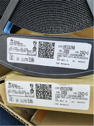

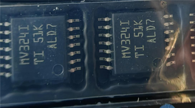

  1. Defect Rate: 100%Quantity: As shown in the image above, Malaysian batch
    Marking on the chip:
MV358I
TI 51K
ALD2
Fig. 2
3.Problem Summary:
Our company has been using the LMV324IPWR chip for over 15 years, with more than one million units utilized. However, we have recently encountered significant issues with a batch of LMV324IPWR chips sourced from Malaysia. We noticed a change in the marking (silkscreen) of the chips, and after mounting them onto our circuit boards, the failure rate is 100%.

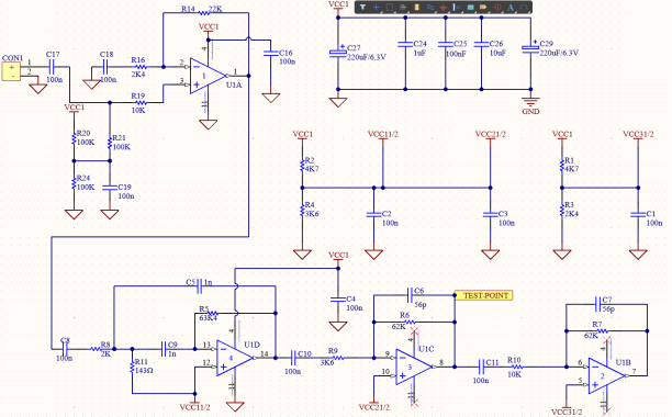

Specifically, the output signal of the LMV324IPWR operational amplifier becomes 100% saturated after amplification. Our circuit configuration consists of a first-stage non-inverting amplifier followed by a second-stage band-pass amplifier. The oscillation occurs at the second stage.

Schematic Diagram of LMV324IPWR
Fig. 3
In Figure 3, VCC1 is connected to the positive terminal of a clean 5V power supply, and GND is connected to the negative terminal of the clean power supply.CON1 serves as the sensor input signal pin.U1A, U1B, U1C, and U1D correspond to the four operational amplifiers in the LMV324IPWR.
TEST-POINT are oscilloscope test points.

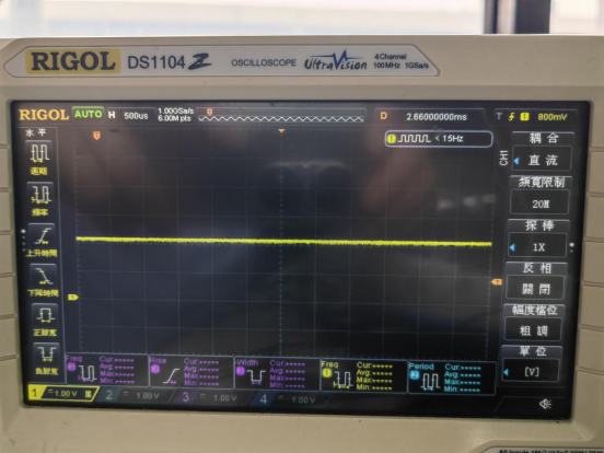

Tests were conducted using LMV324IPWR chips from inventory dated 2011 to 2023, with a 100% pass rate. Over 1 million units of LMV324IPWR have been verified.
The oscilloscope was connected to TEST-POINT in Figure 3, and the normal waveform is shown in Figure 4 below:
Fig. 4
The normal waveform when there is no input signal at CON1 is a straight line at 2V. The normal waveform is shown in Figure 5 below:
Fig. 5

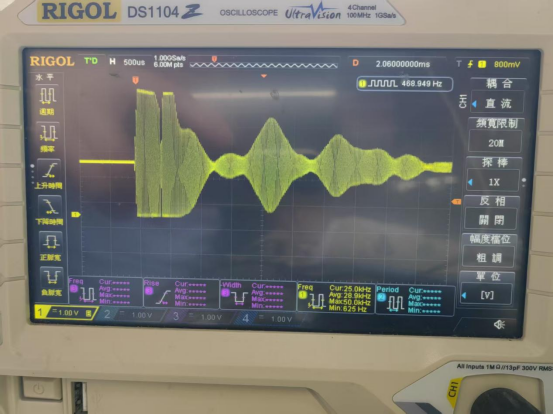

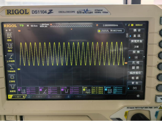

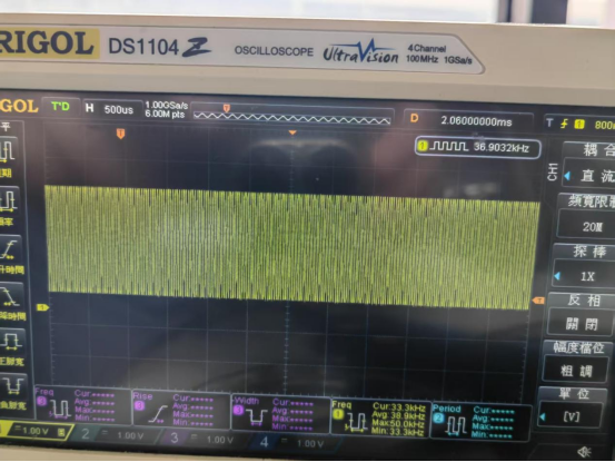

When using the LMV324IPWR chips from the current Malaysian batch, a 100% defect rate was observed, with all units exhibiting oscillation waveforms.
The oscilloscope was connected to TEST-POINT in Figure 3, and the resulting waveforms are shown in Figures 6 to 7 below:
             Fig. 6
Fig. 7
After disconnecting CON1 in Figure 3 and using the LMV324IPWR chips from the Malaysian batch, TEST-POINT consistently shows saturated oscillation waveforms as illustrated in Figures 6 and 7.

Only recently, with the use of the Malaysian batch chips shown in Figure 2, totaling 26,000 units, a 100% defect rate was encountered. We suspect there is a significant quality defect in this new Malaysian batch of chips. Please take this issue seriously and help us resolve it. We believe that this batch of chips will also cause widespread defects in other customers' applications.
