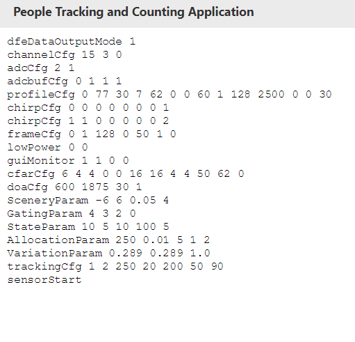

IWR1642 的RF参数选择
请问这个些数字代表的参数是多少呢?能帮我解析一下吗?

  • 您好 CFARCFG和您提供的文件里i的说明没有对应,请问您可以帮我解释一下这行设置参数吗?

  • 您好,我看了,但是无法对应。
  • 你好,
    不好意思,没有注意到你看的是people counting例程。
    这一块。需要你直接看代码了。两个地方,参考如下
    MSS中的CLI.C
    C:\ti\mmwave_industrial_toolbox_3_1_0\labs\lab0011-pplcount\lab0011_pplcount_pjt\radarDemo\chains\RadarReceiverPeopleCounting\mmw_PCDemo\mss\cli.c
    static int32_t MmwDemo_CLICfarCfg (int32_t argc, char* argv[])
    	mmwDemoCfarConfig     cfarCfg;
        MmwDemo_message     message;
        /* Sanity Check: Minimum argument check */
        if (argc != 13)
            CLI_write ("Error: Invalid usage of the CLI command\n");
            return -1;
        /* Initialize the ADC Output configuration: */
        memset ((void *)&cfarCfg, 0, sizeof(mmwDemoCfarConfig));
        //System_printf("CFAR config\n");
        //cliCfg.tableEntry[4].helpString     = "<detMode> <discardLeft> <discardRight> <refWinSize1> <refWinSize2> <guardWinSize1> <guardWinSize2> <thre>";
        /* Populate configuration: */
        cfarCfg.cfarMethod       = (uint16_t) atoi (argv[1]);
        cfarCfg.cfarDiscardRangeLeft  = (uint16_t) atoi (argv[2]);
        cfarCfg.cfarDiscardRangeRight = (uint16_t) atoi (argv[3]);
        cfarCfg.cfarDiscardAngleLeft  = (uint16_t) atoi (argv[4]);
        cfarCfg.cfarDiscardAngleRight = (uint16_t) atoi (argv[5]);
        cfarCfg.refWinSize[0]    = (uint16_t) atoi (argv[6]);
        cfarCfg.refWinSize[1]    = (uint16_t) atoi (argv[7]);
        cfarCfg.guardWinSize[0]  = (uint16_t) atoi (argv[8]);
        cfarCfg.guardWinSize[1]  = (uint16_t) atoi (argv[9]);
        cfarCfg.rangeThre             = (float) atoi (argv[10]) * 0.1f;
        cfarCfg.azimuthThre     = (float) atoi (argv[11]) * 0.1f;
        cfarCfg.log2MagFlag        = (uint16_t) atoi (argv[12]);
        //System_printf("CFAR config:method = %d\n", cfarCfg.cfarMethod);
        /* Save Configuration to use later */
        memcpy((void *)&gMmwMssMCB.cfg.cfarCfg, (void *)&cfarCfg, sizeof(mmwDemoCfarConfig));
        /* Send configuration to DSS */
        memset((void *)&message, 0, sizeof(MmwDemo_message));
        message.type = MMWDEMO_MSS2DSS_CFAR_CFG;
        memcpy((void *)&message.body.cfar, (void *)&cfarCfg, sizeof(mmwDemoCfarConfig));
        if (MmwDemo_mboxWrite(&message) == 0)
            return 0;
        else
            return -1;
    DSS中的DATAPATH.C
    interframe processing 内的内容,你可以找到CFAR的处理。
