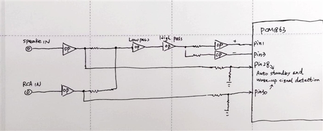

PCM1863: Can the PCM1863 signal input be separated from the automatic standby and wake-up signal detection channels
Part Number: PCM1863
The two analog inputs(RCA and Speaker in) are mixed, filtered through high-pass and low-pass filters, and then converted to differential mode to enter PCM PIN1/3 as the audio signal path. Before mixing, the single-ended signals of each are taken and enter PIN28/30 for automatic standby and wake-up detection signals. Can this design approach be realized?
ref the following block diagram:
