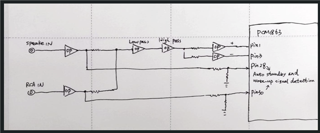

PCM1863: The strength of the detection standby signal required by RCA IN and Speaker IN is different. Can different standby detection signals be achieved?
Part Number: PCM1863
The two analog inputs(RCA and Speaker in) are mixed, filtered through high-pass and low-pass filters, and then converted to differential mode to enter PCM PIN1/3 as the audio signal path. Before mixing, the single-ended signals of each are taken and enter PIN28/30 for automatic standby and wake-up detection signals. Can this design approach be realized?
ref the following block diagram:
Yes this will work. Make sure you understand section 9.3.10.2 of the datasheet so that you can configure the energysense for your needs.
Asking again questions:The strength of the detection standby signal required by RCA IN and Speaker IN is different. Can different standby detection signals be achieved?
ref below requirements
