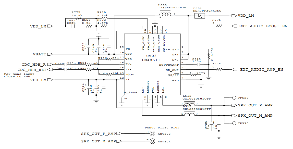

LM48511 output is abnormal
Other Parts Discussed in Thread: LM48511
Output RMS value is just 500mV. Target value is more than 4.4V.

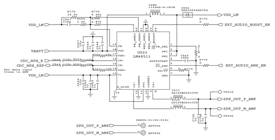

Below is our schematic.
VBATT:4.2V, VDD_LM:7.8V
Input signal is single input.(CDC_HPH_REF is analog ground)

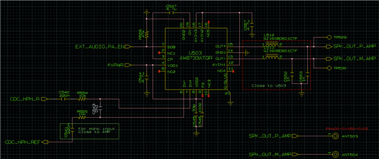

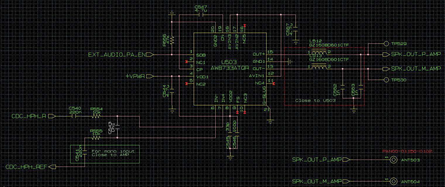

With the same input signal using AW8733(AMP) output RMS value is 4V.
Please tell me how can i debug LM48511 in this case.
