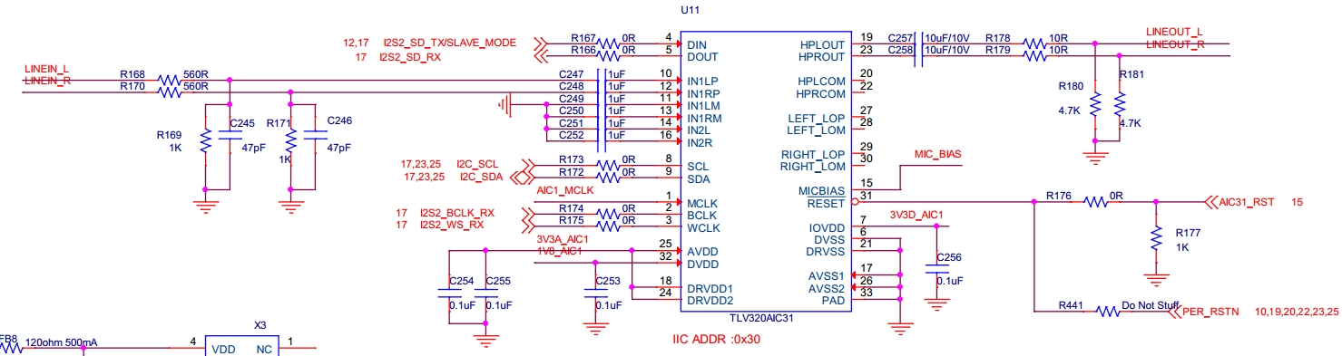

我们现在使用的TLV320AIC3104,客户反映音频输出有底噪,我们进行了复测,确认存在类似的问题,请帮忙一起解决一下该问题。
具体问题描述:配置完成器件后,由CPU发送I2S数据,如果为0,示波器显示无明显底噪;如果数据不为0,例如输出1,示波器底噪峰峰值超过400mv,输出其它值时,底噪仍然超过400mv
目前该器件的配置为
       tlv320aic31_write(IIC_device_addr[chip_num],0x1,0x80);
        msleep(10);
        /*CLKDIV_IN uses MCLK*/
     tlv320aic31_write(IIC_device_addr[chip_num], 102, 0x32);
    /*PLL disable and select Q value*/
     tlv320aic31_write(IIC_device_addr[chip_num], 3, 0x10);
        /*left and right DAC open*/
        tlv320aic31_write(IIC_device_addr[chip_num], 7,  0xa);/* FSref = 48 kHz */
        /*sample*/
     tlv320aic31_write(IIC_device_addr[chip_num], 2,  0x44);/* FS = FSref/3 */
        /*ctrl mode*/
        tlv320aic31_write(IIC_device_addr[chip_num], 8,  0xf0);/* master mode */
        /*Audio Serial Data Interface Control*/
        tlv320aic31_write(IIC_device_addr[chip_num], 9,  0x7);/* I2S mode,16bit */
        /*Audio Codec Digital Filter Control Register*/
        tlv320aic31_write(IIC_device_addr[chip_num], 12,  0x50);
        //tlv320aic31_write(IIC_device_addr[chip_num], 25,  0x0);
        tlv320aic31_write(IIC_device_addr[chip_num], 25,  0x40);
        tlv320aic31_write(IIC_device_addr[chip_num], 17,  0xf);
        tlv320aic31_write(IIC_device_addr[chip_num], 18,  0xf0);
        tlv320aic31_write(IIC_device_addr[chip_num], 15,  0x0);
        tlv320aic31_write(IIC_device_addr[chip_num], 16,  0x0);
        tlv320aic31_write(IIC_device_addr[chip_num], 19,  0x04);
        tlv320aic31_write(IIC_device_addr[chip_num], 22,  0x04);
        tlv320aic31_write(IIC_device_addr[chip_num], 28,  0x0);
        tlv320aic31_write(IIC_device_addr[chip_num], 31,  0x0);
        /*out ac-coupled*/
        tlv320aic31_write(IIC_device_addr[chip_num], 14, 0x80);
        /*left and right DAC power on*/
        tlv320aic31_write(IIC_device_addr[chip_num], 37, 0xc0);
        /*out common-mode voltage*/
        tlv320aic31_write(IIC_device_addr[chip_num], 40, 0x80);
        /*out path select*/
        tlv320aic31_write(IIC_device_addr[chip_num], 41, 0x1);
        /*out path select*/
        tlv320aic31_write(IIC_device_addr[chip_num], 42, 0xa8);
        /*left DAC not muted*/
        tlv320aic31_write(IIC_device_addr[chip_num], 43, 0x0);
        /*right DAC not muted*/
        tlv320aic31_write(IIC_device_addr[chip_num], 44, 0x0);
        tlv320aic31_write(IIC_device_addr[chip_num], 47, 0x80);
        /*HPLOUT is not muted*/
        //tlv320aic31_write(IIC_device_addr[chip_num], 51, 0x9f);
        tlv320aic31_write(IIC_device_addr[chip_num], 64, 0x80);
        /*HPROUT is not muted*/
        //tlv320aic31_write(IIC_device_addr[chip_num], 65, 0x9f);
        /*out short circuit protection*/
        tlv320aic31_write(IIC_device_addr[chip_num], 38, 0x3e);
原理图:
