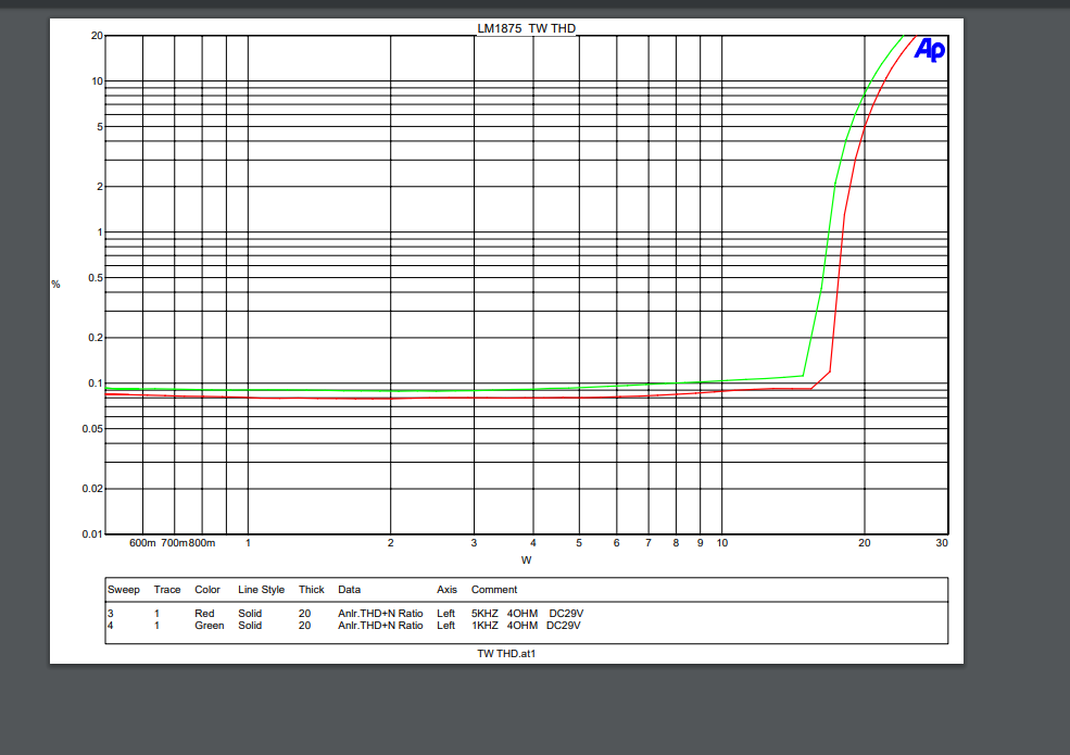

dear all
附件THD曲线是否还有提升的空间.
我们用LM1875做Tweeter.
  • 提升THD的话,建议还是从layout方面入手,datasheet P7中DISTORTION部分也对low THD的介绍有布线建议和要求:
    For low THD, it is also necessary to keep the power supply traces and wires separated from the traces and wires connected to the inputs of the LM1875. This prevents the power supply currents, which are large and nonlinear, from inductively coupling to the LM1875 inputs. Power supply wires should be twisted together and separated from the circuit board. Where these wires are soldered to the board, they should be perpendicular to the plane of the board at least to a distance of a couple of inches. With a proper physical layout, THD levels at 20 kHz with 10W output to an 8Ω load should be less than 0.05%, and less than 0.02% at 1 kHz.
