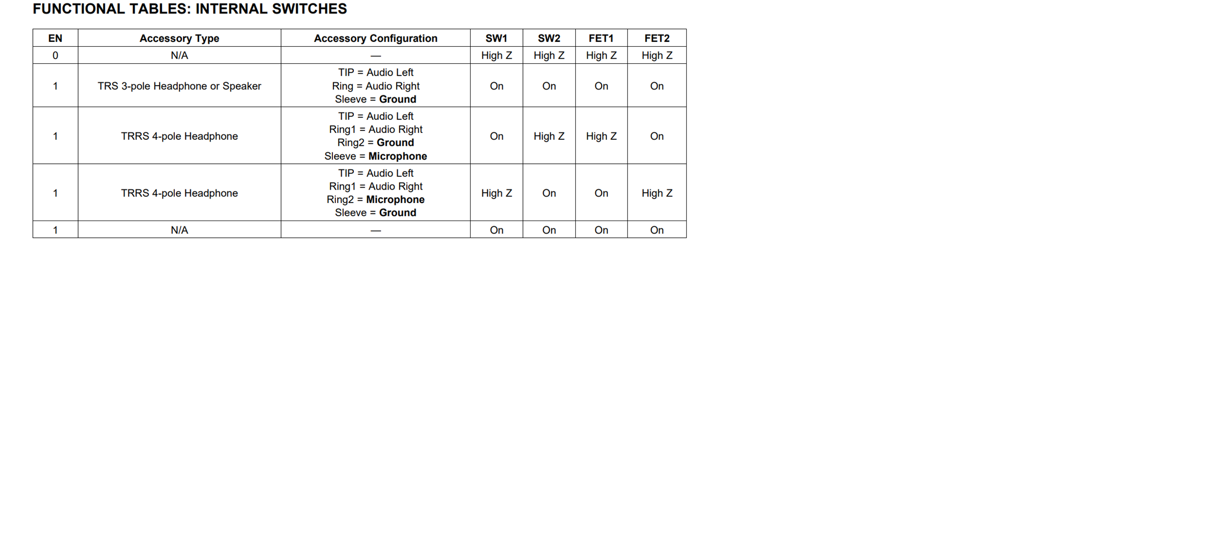

What is the working principle of TS3A226AE IC automatic switching earphone mode?What determines switching?
Other Parts Discussed in Thread: TS3A226AE
请问TS3A226AE这款IC,自动切换耳机模式的工作原理是什么?是通过什么来判断切换的?

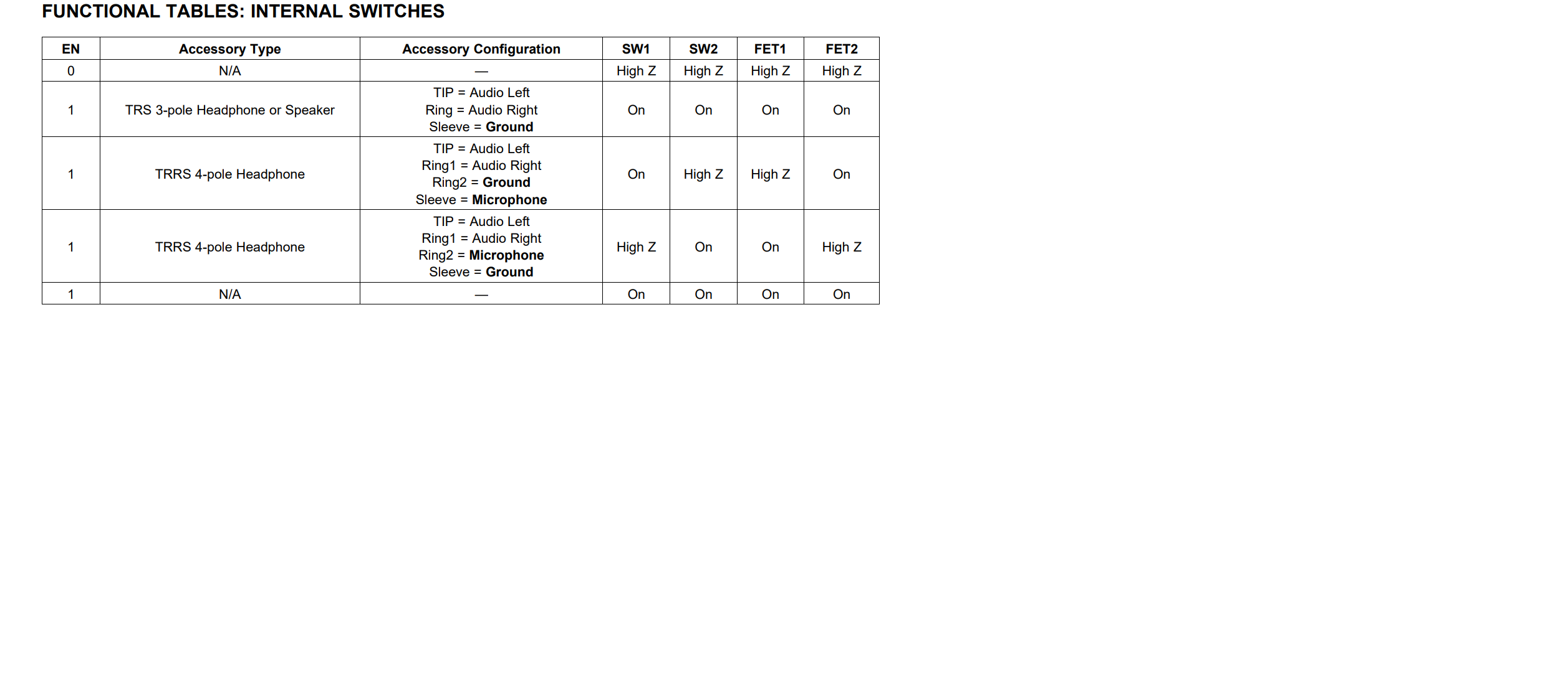

  • 您好,是根据耳机的类型进行自主切换,比如3极或4级的配件插到移动设备中的方法是不一样的,,您看下面真值表中Accessory Congifuration的连接方式, 换句话说,根据这种配置方式的不同来自主切换。
    The autonomous  detection feature allows end users to plug in accessories with different audio pole configurations  into the mobile device and have them operate properly。
