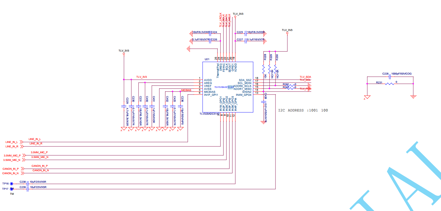

TLV320ADC5140作为I2S从机,无法正常工作。读取0x76寄存器为0,显示ADC通道没有工作,读取0x15寄存器为0xff。
Other Parts Discussed in Thread: TLV320ADC5140
/* 主机给从机提供MCLK = 24.576MHz,(GPIO1管脚复用为MCLK input)BCLK= 3.072MHz,fs = 48kHz*/

I2C_Write(tlv5140_addr,ADCX140_CLK_SRC,0x58); /* */
I2C_Write(tlv5140_addr,ADCX140_GPIO_CFG0,0xa6); /* GPIO1 provide MCLK = 24.516MHz*/

I2C_Write(tlv5140_addr,ADCX140_IN_CH_EN,0xe0); /* channel1 、channel2 channel3 input en */
I2C_Write(tlv5140_addr,ADCX140_ASI_OUT_CH_EN,0xe0); /* channel1 、channel2 channel3 output en */
