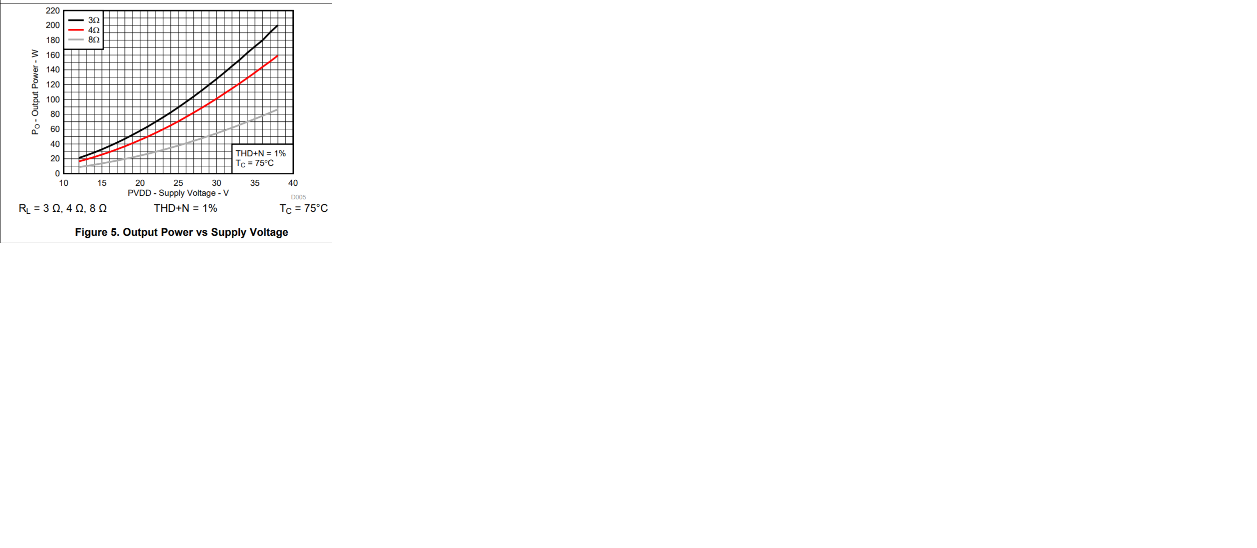

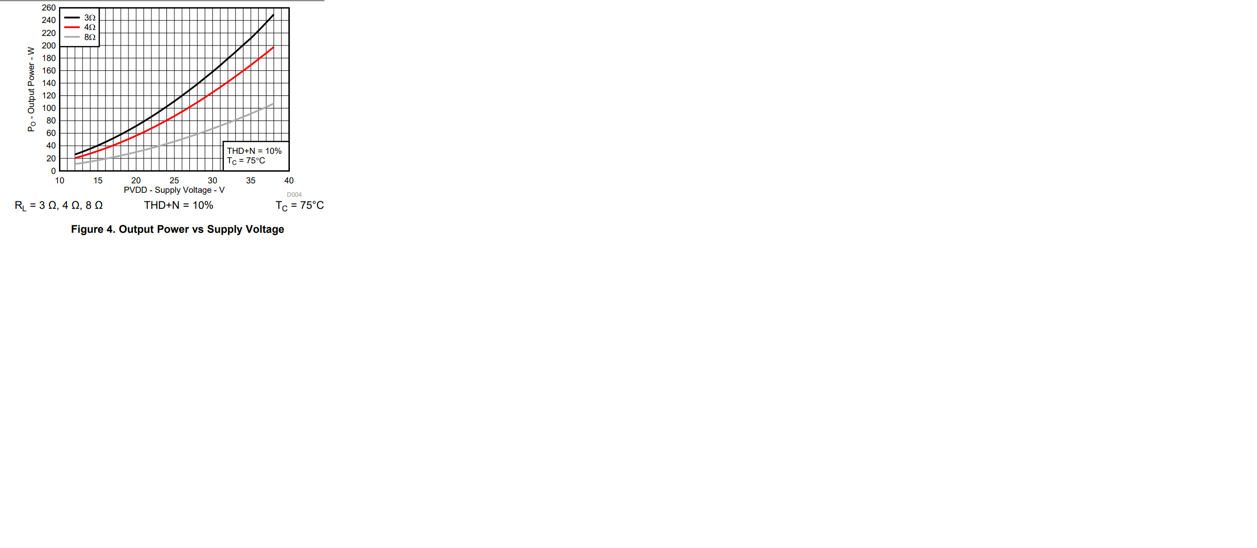

TPA3251如何做到180W的功率,电压12V,电流应该多少,请推荐DCDC
Other Parts Discussed in Thread: TPA3251, TPA3255
如题
