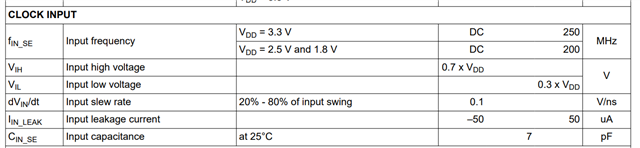

Currently I have a application requirement sensitive to phase noise and need four clock output, so I choose LMK1C1104 as the clock buffer. The datasheet of LMK1C1104 shows that the input and output of this buffer only support lvcmos level standard
However, the output of selected DCXO(KT1612A) is clipped sine wave.
Does this IC support a clipped sine wave input clock? If I apply this method, will it affect the phase noise of the output clock?
