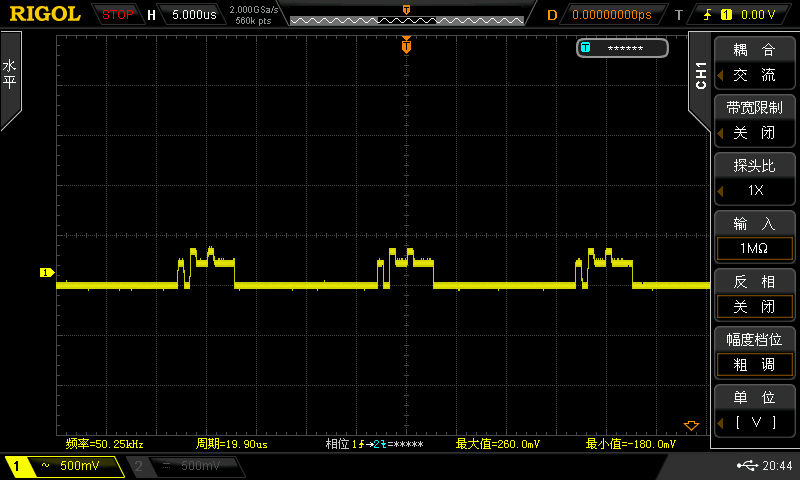

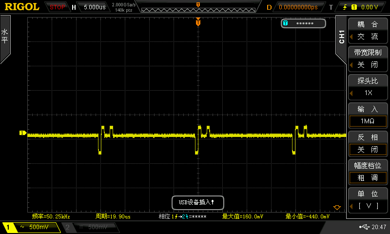

使用THS8200做RGB888转YPbPr(720P),无显示
Other Parts Discussed in Thread: THS8200
使用THS8200做RGB888转YPbPr(720P),后端无显示,
Y、Pb、Pr的输出波形参看附件图片,
寄存器配置为:
      THS8200_write(0x03,0x01);
      THS8200_write(0x19,0x01);
      THS8200_write(0x1A,0x00);
      THS8200_write(0x1B,0x00);
      THS8200_write(0x1C,0x28);
      THS8200_write(0x36,0x80);
      THS8200_write(0x38,0x82);
      THS8200_write(0x3D,0x00);
      THS8200_write(0x4A,0xFC);
      THS8200_write(0x82,0x03);
急求大神指点
