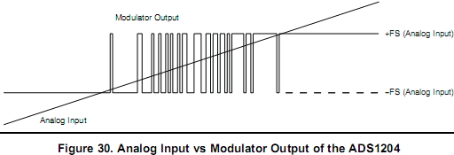

在ADS1204中2V对应的16位数字量是多少呢?-2V对应的又是多少?
在芯片手册上只看到以下这段话:A differential input signal of 0V will ideally produce a stream of ones and zeros that are high 50% of the time and low 50% of the time. A differential input of +2V produces a stream of ones and zeros that are high 80% of the time. A differential input of –2V produces a stream of ones and zeros that are high 20% of the time.
  • 其实意思说得很明白,-2V 输入,对应输出信号中,20% 为高电平。
    你可能并没有理解这个 ADC 的输出特性。他是用信号占空比来表征转换结果的。
    好好理解一下这张图
