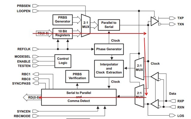

我使用TLK1221连接一个1394设备,在初始化阶段需要进行速度协商,需要接收来自TI1394芯片的TONE信号,我使用TLK1221的LOOPEN发送tone,使用LOS来检测TONE,但是当我把LOOPEN拉高时,我为什么检测不到RXP和RXN上的LOS信号,只能检测到TXP和TXN上发出的信号,难道是内部自环了吗,但是根据数据手册上的图,LOS的检测只是检测接收端,跟内环没有关系啊。

Hi Zhi,
如器件手册所述,LOOPEN使能的是内部环回,发送侧的数据在内部传输给接收侧的输入端。
When LOOPEN is high (active), the internal loopback path is activated. The transmitted serial data is directly routed to the inputs of the receiver. This provides a self-test capability in conjunction with the protocol device. The TXP and TXN outputs are held in a high-impedance state during the loopback test. LOOPEN is held low during standard operational state with external serial outputs and inputs active.
