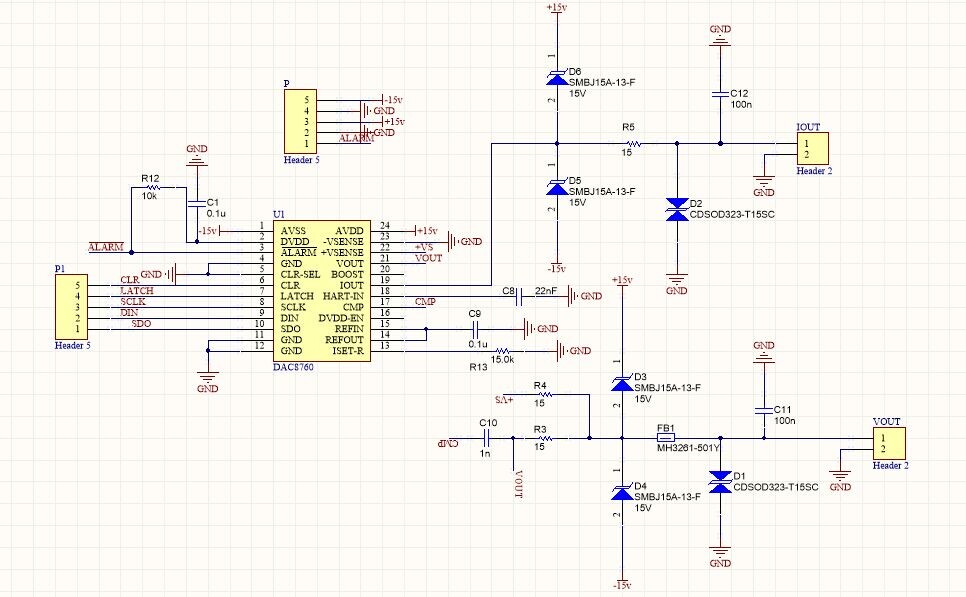

这是我DAC8760的程序和原理图,能否帮我检查下哪里有问题
Other Parts Discussed in Thread: DAC8760

#include<msp430.h>
#include<DAC8760.h>
函数功能:
写数据****
参数:com:前8位命令;
dat:数据
void DAC8760_write_byte(unsigned char com, unsigned int dat)
 unsigned char i=0;
 unsigned long data;
 data=(((unsigned long)com)<<24)|(dat<<8);
 DAC8760_LATCH_0_();
 DAC8760_SCLK_0_();
 for(i=0;i<24;i++)
  DAC8760_SCLK_0_();
  if(data&0x80000000)
   DAC8760_DIN_1_();
  else
   DAC8760_DIN_0_();
  delay_us(1);
  DAC8760_SCLK_1_();
  data<<=1;
  delay_us(1);
 DAC8760_SCLK_0_();
 delay_us(1);
 DAC8760_LATCH_1_();
 DAC8760_DIN_1_();
void DA_init()
  CLk_clear;
   DAC8760_write_byte(DACResetReg,0x0001);
   delay_us(1);
   DAC8760_write_byte(DACConfigurationReg,0x0088);
   delay_us(1);
   DAC8760_write_byte(DACControlReg,0x1006);
   delay_us(1);
   DAC8760_write_byte(DACDataReg,0xffff);
   delay_us(1);
 输出端一直为0,不知道是哪里有问题,检查了很久没结果,求各位大神帮帮忙
