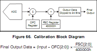

请教ADS1248校准流程。数据手册太含糊了。总共有三个校准命令,以下是个人理解,不知道是否正确。
SELFOCAL Self offset calibration SYSOCAL—Offset system calibration.
This command initiates a system offset calibration. For a system offset calibration, the input should be externally set to zero. The OFC register is updated when this operation completes.
1.SELFOCAL校准时,PGA如何设置?是按工作时的需要来设置还是设为1?
2.SELFOCAL是不是可以使用MUX1的MUXCAL2:0设置为001(Inputs shorted to midsupply (AVDD + AVSS)/2)? 还是指输入端必须接到GND,MUXCAL2:0设置为000(Normal operation)?
SYSGCAL—System gain calibration.
This command initiates the system gain calibration. For a system gain calibration, the input should be set to full-scale. The FSC register is updated after this operation.
1.PGA如何设置?按工作时的需要来设置还是设为1?.实际使用时PGA为其它时,是否需要将输入端接入Vref/PGA的差分电压,并设置MUXCAL为000(Normal operation),再进行SYSGCAL的校准?
2.如果使用MUXCAL2:0设置为010(VREFP – VREFN (full-scale)),那么PGA会被自动设为1还是需要手动设置PGA到1?
SELFOCAL—Self offset calibration.
This command initiates a self-calibration for offset. The device internally shorts the inputs and performs the calibration. The OFC register is updated after this operation.
1.SELFOCAL校准需要设置MUXCAL2:0吗?设置成啥值?
还有就是这3个校准有顺序要求吗?
