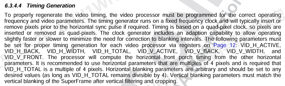

hi,on datasheets page37,it says in superframe mode vertical blanking must divisible by 4;I want konw if we do not use superframe,the vertical blanking still must divisible by 4 ?Also,without using superframe,does the horizontal still need to be divided by 4?
We have currently configured a display screen parameter, and the horizontal and vertical parameters are not divided by 4,Will there be any problems?image.png
