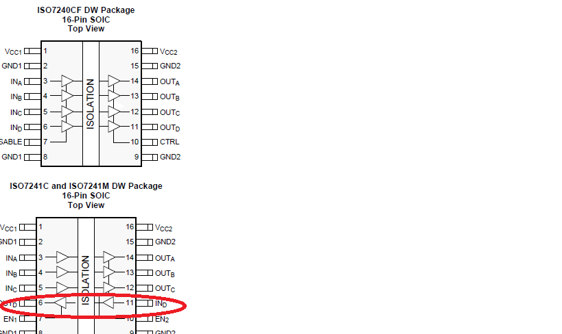

datasheet中一般会有说明的哈,以ISO724x为例,在Page1就有这样描述:
The ISO7240x family of devices has all four channels in the same direction.
The ISO7241x family of devices has three channels in the same direction and one channel in the opposition direction.
The ISO7242x family of devices has two channels in each direction.
