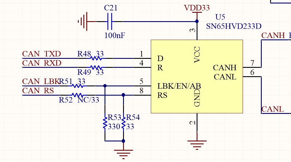

调试sn65hvd233 出现的问题
Other Parts Discussed in Thread: SN65HVD233
根据datasheet 第2页的描述:
A logic high on the loopback LBK pin 5 of the SN65HVD233 places the bus output and bus input in a
high-impedance state. The remaining circuit remains active and available for driver to receiver loopback,
self-diagnostic node functions without disturbing the bus
如果将LBK引脚拉高,那么CANH、CANL的电平应该不收引脚D (即CAN的发射)的影响,但实际发现D用波形时,CANH、CANL也有波形。
有没有谁碰到过?
