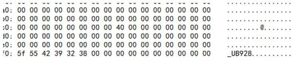

主机端用i2cdump命令读取TI924Q信息,发现读取出来的型号是928,请帮忙确认下,谢谢!

    How are you dumping the registers? Through ALP or through another method? What registers is this info being found?
    您这个寄存器是怎么读取的?是通过ALP还是通过其他方法?
    Please re-dump the registers either with the same method or, if possible, with ALP, and see if the same information appears.
    请用相同的方法再读取试试,或者使用ALP去验证下是否还出现相同的信息。
    Additionally, please check the top marking of the device and confirm whether it is a 924 or 928.
    另外,请确认芯片的顶端标识,可以将顶端标识发过来确认下924或928.
