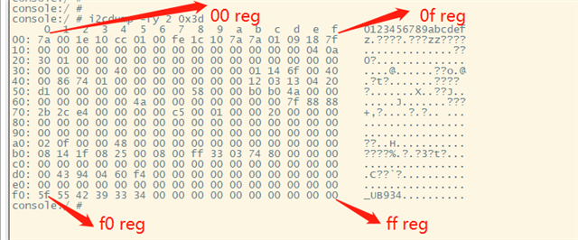

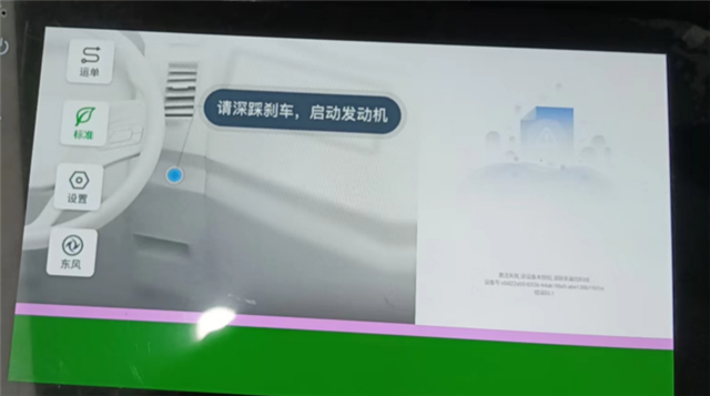

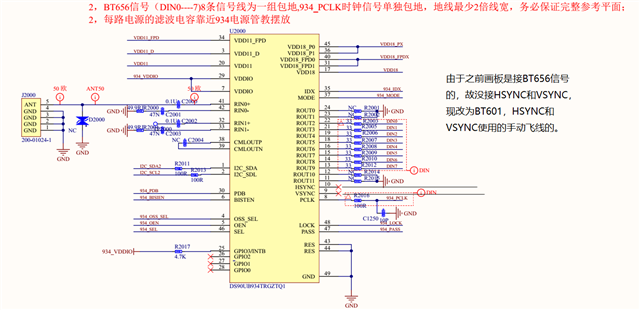

传输的图像分辨率应该为1280*720,但图像上方有部分被截了,而下方又有一部分没有,请帮忙看下是否需要对934进行配置,934寄存器配置如下:
0 1 2 3 4 5 6 7 8 9 a b c d e f 0123456789abcdef
00: 7a 00 1e 10 cc 01 00 fe 1c 10 7a 7a 01 09 58 7f z.????.???zz??X?
10: 00 00 00 00 00 00 00 00 00 00 00 00 00 00 04 0a ..............??
20: 30 01 00 00 00 00 00 00 00 00 00 00 00 00 00 00 0?..............
30: 00 00 00 00 40 00 00 00 00 00 00 01 14 6f 00 40 ....@......??o.@
40: 00 86 74 01 00 00 00 00 00 00 00 12 03 13 04 20 .?t?.......????
50: ca 00 00 00 00 00 00 00 58 00 00 b0 b0 4a 00 00 ?.......X..??J..
60: 00 00 00 00 00 4a 00 00 00 00 00 00 00 7f 88 88 .....J.......???
70: 2b 2c e4 00 00 00 00 c5 00 01 00 00 20 00 00 00 +,?....?.?.. ...
80: 00 00 00 00 00 00 00 00 00 00 00 00 00 00 00 00 ................
90: 00 00 00 00 00 00 00 00 00 00 00 00 00 00 00 00 ................
a0: 02 0f 00 00 08 00 00 00 00 00 00 00 00 00 00 00 ??..?...........
b0: 08 14 1f 08 25 00 08 00 ff 33 03 74 80 00 00 00 ????%.?.?3?t?...
c0: 00 00 00 00 00 00 00 00 00 00 00 00 00 00 00 00 ................
d0: 00 43 94 04 60 f4 00 00 00 00 00 00 00 00 00 00 .C??`?..........
e0: 00 00 00 00 00 00 00 00 00 00 00 00 00 00 00 00 ................
f0: 5f 55 42 39 33 34 00 00 00 00 00 00 00 00 00 00 _UB934..........
