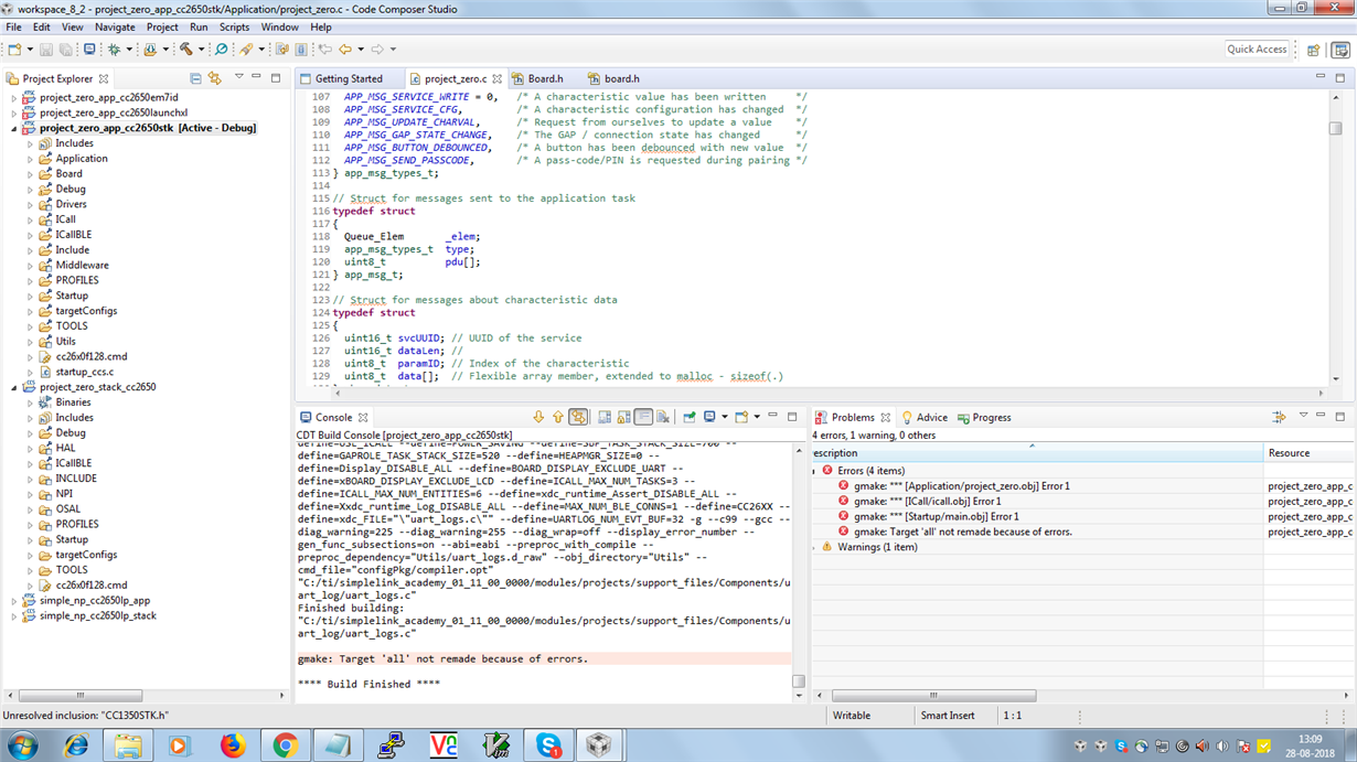

    从 setup_simplelink_academe_01_11_00_0000 cc2650导入项目零、并修改 项目零以便在定制板上的 CC2640F128上工作 、当 我构建项目时会出现以下错误。
    ****纯净的配置构建 Project project_zero_app_cc2650stk ****的调试
    "C:\\ti\\ccsv8\\utils\\bin\\gmake"-j -k -j 2 clean -O

    ****为 project project_zero_app_cc2650stk 构建配置调试****
    "C:\\ti\\ccsv8\\utils\\bin\\gmake"-j -k -j 2 all -O
    编译文件:"../TOOLS/app_ble_uartlog.cfg

    编译文件:"../Application/project_zero.c
    调用:ARM 编译器
    "c:/ti/ccsv8/tools/compiler/ti-cgt-arm_18.1.2.LTS/bin/armcl "-cmd_file="C:\ti\simplelink\ble_sdk_2_02_25\src\config\build_components.opt"-cmd_file="D:/workspace_8_2/project_zero_stack_cc2650/tools/build_build_config.opt"-cmd_component=-ctrade_trade_trade_b_trade_b_trade_b_track_track_track_track_track_track_sd/cc50_track_track_track_track_track_track_track_track_track_track_track_track_包括:-cc50_track_track_track_track_track_track_track_track_track_track_track_track_track_track_track_track_track_track_en_track_track_track_\c64_track_track_b_track_b_track_tr /ti/simplelink/ble_sdk_2_02_02_25/src/components/heapmgr /ti/simplelink/ble_sdk_2_02_02_25/src/common/cc26xx /ti/simplelink/ble_sdk_2_02_02_25/src/profiles/simple_profile /ti/simplelink/ble_sdk_2_02_02_25/src/profiles/simple_profile/cc26xx /ti/simplelink/ble_sdk_2_02_02_25/src/profiles/dev_info /ti/simplelink/ble_sdk_2_02_02_25/src/profiles/roles /ti/simplelink/ble_sdk_2_02_02_25/src/profiles/roles/cc26xx /ti/simplelink/ble_sdk_2_02_02_25/src/icall/inc /ti/simplelink/ble_sdk_2_02_02_25/src/inc /ti/simplelink/ble_sdk_2_02_02_25/src/examples/simple_peripheral/cc26xx/app /ti/simplelink_academy_01_11_00_0000/modules/projects/support_files/Components/uart_log include_path="C:/ti/simplelink/ble_sdk_2_02_02_25/src/controller/cc26xx/inc --include_path="C:/ti/simplelink/ble_sdk_2_02_02_25/src/components/hal/src/target/_common --include_path="C:/ti/simplelink/ble_sdk_2_02_02_25/src/components/hal/src/target --include_path="C:/ti/simplelink/ble_sdk_2_02_02_25/src/components/hal/src/target/_common/cc26xx /ti/simplelink/ble_sdk_2_02_02_25/src/components/services/src/sdata /ti/tirtos_cc13xx_cc26xx_2_21_01_08/products/cc26xxware_2_24_03_17272 --include_path="C:/ti/simplelink/ble_sdk_2_02_02_25/src/components/hal/src/inc --include_path="C:/ti/simplelink/ble_sdk_2_02_02_25/src/components/services/src/saddr --include_path="C:/ti/simplelink/ble_sdk_2_02_02_25/src/components/osal/src/inc /ti/simplelink/ble_sdk_2_02_02_25/src/components/icall/src/inc --include_display_define =/ti/ccsv8/tools/compiler/ti-cgt-arm_18.1.2.LTS/include -- define ICRAP=END_CONFIDA-SAFETY_ENDLE_CONFIDA-CONFIDA-CONFIDA-CONFIDA-CONFIDA-ENCE_ENCE_RAP=ENCE_CONFIDA-CONFIDA-CONFIDA-CONFIDENCE=ENCE_RAP=ENCE_CONFIDA-CONFIDA-CONFIDA-CONFIDA-CONFIDENCE_RAP=ENCE_CONFIDENCE_CONFIDA-CONFIDA-CONFIDENCE_RAP=ENCE_RAP=ENCE_RAP=END=--ENTRUD_CONFIDA-CONFIDA-CONFIDA-CONFIDA-CONFIDA-CONFIDA-CONFIDA-CONFIDA-CONFIDA-CONFIDA-CONFIDENCE_CONFIDA-CONFIDA-CONFIDA-CONFIDENCE_RAP=ENCE_CONFIDENCE define=XDC_file="project_zero.c\"--define=UARTLOG_NUM_EVT_BUF=32 -g -c99 --gcc --diag_warning=225 --diag_warning=255 --diag_warning=off --display_error_number --gen_func_subsections="proc-proc-copy_prefile_build="/Application/project_zero.c --proc-copy_file.configabi_prisd="-out_subsections="-file_build"-file.configabi.tran.for_overview_overview_overview_overview_overview_overview_overview_overview.microcontrollers=255 --isprisprisprisprispris
    >>编译失败
    application/subdir_rules.mk:9:目标'Application/project_zero.obj'的配方失败
    编译文件:"../startup_ccs.c"
    调用:ARM 编译器
    "c:/ti/ccsv8/tools/compiler/ti-cgt-arm_18.1.2.LTS/bin/armcl "-cmd_file="C:\ti\simplelink\ble_sdk_2_02_25\src\config\build_components.opt"-cmd_file="D:/workspace_8_2/project_zero_stack_cc2650/tools/build_build_config.opt"-cmd_component=-ctrade_trade_trade_b_trade_b_trade_b_track_track_track_track_track_track_sd/cc50_track_track_track_track_track_track_track_track_track_track_track_track_包括:-cc50_track_track_track_track_track_track_track_track_track_track_track_track_track_track_track_track_track_track_en_track_track_track_\c64_track_track_b_track_b_track_tr /ti/simplelink/ble_sdk_2_02_02_25/src/components/heapmgr /ti/simplelink/ble_sdk_2_02_02_25/src/common/cc26xx /ti/simplelink/ble_sdk_2_02_02_25/src/profiles/simple_profile /ti/simplelink/ble_sdk_2_02_02_25/src/profiles/simple_profile/cc26xx /ti/simplelink/ble_sdk_2_02_02_25/src/profiles/dev_info /ti/simplelink/ble_sdk_2_02_02_25/src/profiles/roles /ti/simplelink/ble_sdk_2_02_02_25/src/profiles/roles/cc26xx /ti/simplelink/ble_sdk_2_02_02_25/src/icall/inc /ti/simplelink/ble_sdk_2_02_02_25/src/inc /ti/simplelink/ble_sdk_2_02_02_25/src/examples/simple_peripheral/cc26xx/app /ti/simplelink_academy_01_11_00_0000/modules/projects/support_files/Components/uart_log include_path="C:/ti/simplelink/ble_sdk_2_02_02_25/src/controller/cc26xx/inc --include_path="C:/ti/simplelink/ble_sdk_2_02_02_25/src/components/hal/src/target/_common --include_path="C:/ti/simplelink/ble_sdk_2_02_02_25/src/components/hal/src/target --include_path="C:/ti/simplelink/ble_sdk_2_02_02_25/src/components/hal/src/target/_common/cc26xx /ti/simplelink/ble_sdk_2_02_02_25/src/components/services/src/sdata /ti/tirtos_cc13xx_cc26xx_2_21_01_08/products/cc26xxware_2_24_03_17272 --include_path="C:/ti/simplelink/ble_sdk_2_02_02_25/src/components/hal/src/inc --include_path="C:/ti/simplelink/ble_sdk_2_02_02_25/src/components/services/src/saddr --include_path="C:/ti/simplelink/ble_sdk_2_02_02_25/src/components/osal/src/inc /ti/simplelink/ble_sdk_2_02_02_25/src/components/icall/src/inc --include_display_define =/ti/ccsv8/tools/compiler/ti-cgt-arm_18.1.2.LTS/include -- define ICRAP=END_CONFIDA-SAFETY_ENDLE_CONFIDA-CONFIDA-CONFIDA-CONFIDA-CONFIDA-ENCE_ENCE_RAP=ENCE_CONFIDA-CONFIDA-CONFIDA-CONFIDENCE=ENCE_RAP=ENCE_CONFIDA-CONFIDA-CONFIDA-CONFIDA-CONFIDENCE_RAP=ENCE_CONFIDENCE_CONFIDA-CONFIDA-CONFIDENCE_RAP=ENCE_RAP=ENCE_RAP=END=--ENTRUD_CONFIDA-CONFIDA-CONFIDA-CONFIDA-CONFIDA-CONFIDA-CONFIDA-CONFIDA-CONFIDA-CONFIDA-CONFIDENCE_CONFIDA-CONFIDA-CONFIDA-CONFIDENCE_RAP=ENCE_CONFIDENCE define=XDC_file="\"startup_ccs.c\"--define=UARTLOG_NUM_EVT_BUF=32 -g --c99 --gcc --diag_warning=225 --diag_warning=255 --diag_warning=off --display_error_number --gen_func_subsections=proc-preproc_startup-preabi="_preabi_prepkg --abi_build="-copy=en_preoverview_preoverview_overview_overview_overview_overview_overview.prisprisprisprispru.cp.cp.abi.ebug_overview_overview_overview_overview.
    "D:/workspace_8_2/project_zero_app_cc2650stk/Board.h"、第42行:致命错误#1965:无法打开源文件"CC1350STK.h"
    1在编译"../Application/project_zero.c 时检测到灾难性错误。
    编译已终止。
    gmake:***[Application/project_zero.obj]错误1.
    完成构建:"../startup_ccs.c"

    "D:/workspace_8_2/project_zero_app_cc2650stk/board.h"、第42行:致命错误#1965:无法打开源文件"CC1350STK.h"
    1在编译"C:/ti/simplelink/ble_sdk_2_02_02_25/src/components/icall/src/icall.c "时检测到灾难性错误。
    编译已终止。
    gmake:***[iCall/iCall.obj]错误1.
    1在编译"../Startup/main.c 时检测到灾难性错误。
    编译已终止。
    gmake:***[Startup/main.obj]错误1.
    编译已终止。

    首先、simplelink Academy 中包含的项目0是针对 BLE Stack 2.2.1构建的。 此外、请确保您使用的是2.2.1要求用户在发行说明中使用的 TI 编译器。 请在此处查看信息:
