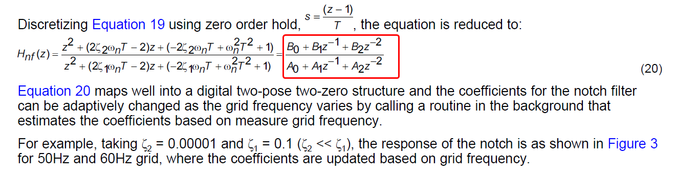

在示例项目PMP23338中关于自适应陷波滤波器的离散形式系数的计算有疑问要请教下:
在函数SPLL_1PH_NOTCH_coeff_calc中关于A0, A1, A2, B0, B1, B2的表达方式不理解,temp1和temp2的值是如何得到的?
我看了SPRABT3A–July 2013–Revised July 2017这篇文章,但里面关于使用ZOH对陷波滤波器离散化后,没有进一步的各个系数表示方法,只有如下的形式,麻烦帮空解答下,谢谢了!

    The coefficients are derived using the **Bilinear Transform (Tustin's method)** with **frequency pre-warping** to convert the continuous-time notch filter to discrete-time.
    The continuous-time notch filter transfer function: H(s) = (s² + 2·c2·ωₙ·s + ωₙ²) / (s² + 2·c1·ωₙ·s + ωₙ²)
    Where:
    - **ωₙ** = notch frequency (rad/s)
    - **c1** = denominator damping coefficient
    - **c2** = numerator damping coefficient (typically 0 for pure notch)
    Bilinear Transform with Pre-warping: The
     code applies the bilinear transform substitution:
    s = (2·Fs) · (z - 1)/(z + 1) Where "Fs" is the sampling frequency.
    Pre-warping corrects frequency distortion: wn2 = 2*Fs*tanf(notch_freq * π * Ts);  // Pre-warped notch frequency
    Coefficient Derivation
    After applying the bilinear transform and expanding the transfer function, the discrete-time form becomes:
    H(z) = (b0 + b1·z⁻¹ + b2·z⁻²) / (1 + a1·z⁻¹ + a2·z⁻²)

  • 非常感谢您这么详细的解答,我一直以为文档中所说 自适应陷波滤波器是使用ZOH方法进行离散化处理,原来使用的是双线性方式。
