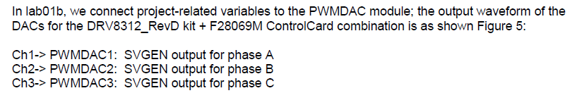

DRV8312-69M-KIT套件的lab中的波形图是用外接示波器采集到的还是用CCS本身采集的?如下图是In lab01b中看PWM通道的波形。

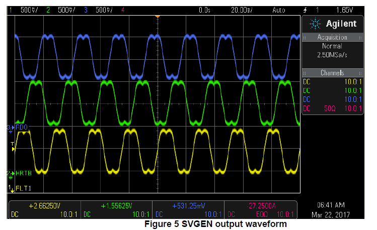

您也使用的CCS内的graph tool
The datalog module can be utilized to store and graph the data. Using the graph tool in CCS, it is possible to implement a virtual oscilloscope to monitor the input/output waveform for datalog-enabled projects.
具体您可以看一下 C:\ti\motorware\motorware_1_01_00_18\docs\labs内的instaspin_labs.pdf的说明
第32页 Setup and use the graph window
