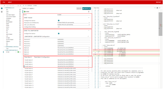

在使用280021的DCSM加密后,使用仿真器的Debug模式,程序能正常运行,
停止仿真,再来一次Debug(试试程序是否加密成功),提示如下:
说明程序加密成功了,但是板子上电重启后就不运行了。
加密配置使用的是sysconfig,配置生成的DCSM.asm 和DCSM.cmd文件,配置如下:
就是把密码简单设置了,RAMLS456 设置保护,Flash0123设置了保护,
板子程序就不运行了。。。。。

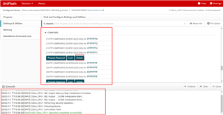

    使用UNIFlash 在我密码区设置密码,其他没操作
    UnLock后,显示
    [2022/7/4 上午8:57:40] [INFO] C28xx_CPU1: GEL Output: RAM initialization done
    [2022/7/4 上午8:57:41] [INFO] C28xx_CPU1: GEL Output: Memory Map Initialization Complete
    [2022/7/4 上午8:57:41] [INFO] C28xx_CPU1: GEL Output: ... DCSM Initialization Start ...
    [2022/7/4 上午8:57:41] [INFO] C28xx_CPU1: GEL Output: ... DCSM Initialization Done ...
    [2022/7/4 上午8:57:41] [INFO] C28xx_CPU1: Performing Security Operation...
    [2022/7/4 上午8:57:41] [INFO] C28xx_CPU1: Unlocking device...
    [2022/7/4 上午8:57:42] [INFO] C28xx_CPU1: Lock status: false
    [2022/7/4 上午8:57:42] [SUCCESS] C28xx_CPU1: Operation completed successfully.

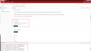

    我再 Erase Flash
    显示如下:
    [2022/7/4 上午8:57:55] [INFO] C28xx_CPU1: GEL Output: RAM initialization done
    [2022/7/4 上午8:57:55] [INFO] C28xx_CPU1: GEL Output: Memory Map Initialization Complete
    [2022/7/4 上午8:57:55] [INFO] C28xx_CPU1: GEL Output: ... DCSM Initialization Start ...
    [2022/7/4 上午8:57:56] [INFO] C28xx_CPU1: GEL Output: ... DCSM Initialization Done ...
    [2022/7/4 上午8:57:56] [INFO] C28xx_CPU1: Erasing Flash memory...
    [2022/7/4 上午8:57:56] [INFO] C28xx_CPU1: GEL Output: ... DCSM Initialization Start ...
    [2022/7/4 上午8:57:57] [INFO] C28xx_CPU1: GEL Output: ... DCSM Initialization Done ...
    [2022/7/4 上午8:58:01] [SUCCESS] C28xx_CPU1: Operation completed successfully.

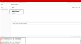

    后面我再添加我不加密的程序烧写:
    显示如下:
    [2022/7/4 上午8:58:16] [INFO] C28xx_CPU1: GEL Output: RAM initialization done
    [2022/7/4 上午8:58:16] [INFO] C28xx_CPU1: GEL Output: Memory Map Initialization Complete
    [2022/7/4 上午8:58:16] [INFO] C28xx_CPU1: GEL Output: ... DCSM Initialization Start ...
    [2022/7/4 上午8:58:17] [INFO] C28xx_CPU1: GEL Output: ... DCSM Initialization Done ...
    [2022/7/4 上午8:58:17] [INFO] C28xx_CPU1: GEL Output: ... DCSM Initialization Start ...
    [2022/7/4 上午8:58:18] [INFO] C28xx_CPU1: GEL Output: ... DCSM Initialization Start ...
    [2022/7/4 上午8:58:19] [INFO] C28xx_CPU1: GEL Output: ... DCSM Initialization Done ...
    [2022/7/4 上午8:58:38] [SUCCESS] Program Load completed successfully.
    再这个烧写状态下,密码区还是原先的1234,
    板子断电重启,测试发现板子程序不运行。
