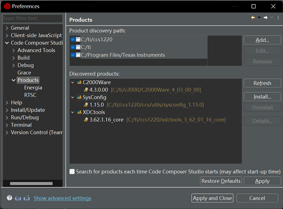

CCS9.1  C2000 Ware4.02,编译28374s valley switching的例程时报下面的错,console显示如下:
**** Build of configuration CPU1_RAM for project epwm_ex6_valley_switching ****
"C:\\ti\\ccs910\\ccs\\utils\\bin\\gmake" -k -j 12 all -O
Building file: "../epwm_ex6_valley_switching.syscfg"
Invoking: SysConfig
"C:/ti/ccs910/ccs/utils/sysconfig/sysconfig_cli.bat" -d "F2837xS" -s "C:/ti/c2000/C2000Ware_4_02_00_00/.metadata/sdk.json" -o "syscfg" --package F2837xS_176PTP --part F2837xS_176PTP "../epwm_ex6_valley_switching.syscfg"
Usage:
cli [-o <dir>] [-s <file>] [-u <string>] [-b <name>] [-d <name>] [-p <name>] [-r <name>] [--treatWarningsAsErrors] <script>
cli --help
cli --version
example: cli -s meta_data/sdk.json -d MSP432P401R scripts/two_uarts.js
example: -s sdk.json -d MSP432P401R -o ./display_cfg sdk/cfgs/display.syscfg
Note that the all arguments other than '--help' and '--version' may also be
specified via the script with an embedded @cliArgs comment directive.
E.g. // @cliArgs -d MSP432P401R
If an argument is embedded in a script and exliciltiy specified via the CLI
then precedence is given to the CLI arguments. Additionally, specifying
"--board" or "--device" on the CLI will override any "--board" and "--device"
arguments specified in the script.
subdir_rules.mk:19: recipe for target 'build-1282829025-inproc' failed
Invalid argument '-s': C:\ti\c2000\C2000Ware_4_02_00_00\.metadata\sdk.json: Validation failed: [
"keyword": "additionalProperties",
"dataPath": "",
"schemaPath": "#/additionalProperties",
"params": {
"additionalProperty": "boardPath"
"message": "should NOT have additional properties"
gmake[1]: *** [build-1282829025-inproc] Error 1
subdir_rules.mk:16: recipe for target 'build-1282829025' failed
gmake: *** [build-1282829025] Error 2
gmake: Target 'all' not remade because of errors.
**** Build Finished ****
请问是什么原因导致的,如何解决?
