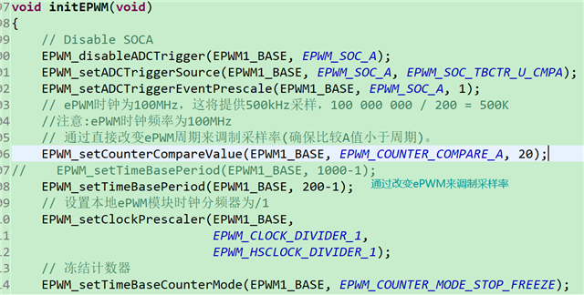

  • 嗯嗯,我同意最大采样率是如此计算,但是在C200wave的例程中,adc_ex2_soc_epwm.c,这个例程,采样窗口(ACQPS)是15个时钟周期,也就是75ns,我通过改变epwm的频率从而去控制ADC的采样率,但是最大只能达到大约500Ksps~600Ksps的速度,请问要如何才能达到3M左右的可控采样率呢?
    下图是我根据例程adc_ex2_soc_epwm.c配置的采样率,再大读取的波形就不正确了。
  • 参考下工程师的回复:
    This example only uses 1 ADC, which will have some delay because it's doing 1 conversion and then reading that result. The best way to try and achieve a higher sampling rate is using many SOCs (all if possible). You can trigger the first SOC however you want and then have each EOC trigger the next SOC so that you are getting continuous conversions. If you are having the ePWM trigger each conversion on 1 SOC, the throughput of the ADC will most likely be lower than the maximum possible.
    Also, keep in mind that depending on how long the ISR is (this example seems okay, but a customer use-case may vary), the sampling rate may be affected as well as the accuracy of the result.
